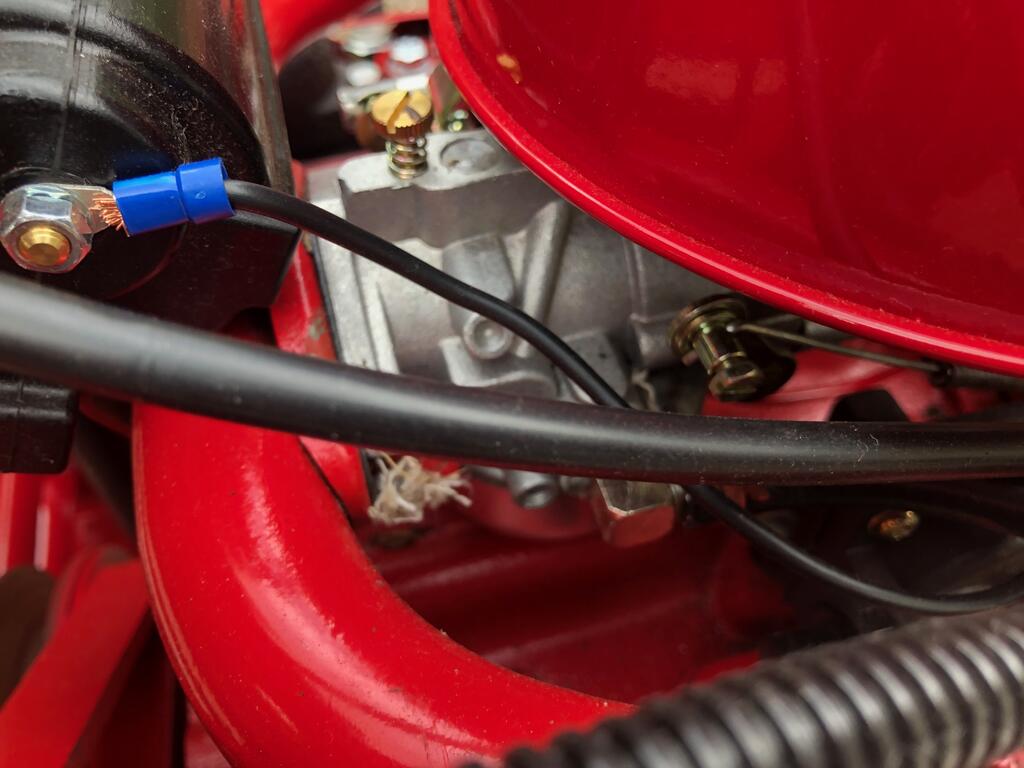

3WHDave 60 #1 Posted May 24, 2020 (edited) The D-180 lives! I took the monster on its maiden voyage yesterday, and took a picture of the machine on my front lawn with a boom hooked to the three point hitch. The hydraulics work fine, all that’s left to do now is to adjust the neutral position (which sounds like fun). The trans-axle went together fine the second time, as I manage to wipe out to needle bearings by leaving the woodruff key on the end of the shaft, not one of my prouder moments! After taking a picture on the front lawn the tractor didn’t start correctly, and was acting as though it was flooded. I managed to limp it back to my garage, we were upon examination I found that the vacuum hose for the governor had come off the carburetor. I reconnected it but still, it was not running correctly and eventually stalled. I spent a good hour examining that last night and found that the vacuum governor hose had become disconnected at the carburetor, so I reconnected it. Still, the engine would not start and act as though it was flooded. I pulled the plugs, clean them, sprayed ether in the carburetor, but no start!I simply assumed that I must’ve flooded the machine, and decided to let it sit overnight. This morning it started, but again it ran very rough and would not warm up. Every attempt to shut the carburetor off resulted in a stall. I broke out the manual, set the idle mixture and the fuel mixture screws pulled the plugs again, clean them and gapped them, and was able to start the motor. However, it was running very rough. As I looked into the carburetor I could see that the butterfly valve was closed however, the choke lever was set to run! I don’t know how this is possible, and I do seek advice. I have an OEM dashboard and an OEM carburetor! Ideas? Edited May 24, 2020 by 3WHDave 3 7 1 Share this post Link to post Share on other sites

bc.gold 3,406 #9 Posted May 27, 2020 I always remove the plastic garbage or use crimps with out the plastic then use moisture proof shrink tube to avoid future electrical issues caused by corrosion. In addition always solder the wire to the connector. 1 Share this post Link to post Share on other sites
3WHDave 60 #10 Posted May 28, 2020 Thank BCGOLD, I agree, and will take your advice. This machine shakes way-too-much for a simple crimp. 1 Share this post Link to post Share on other sites
