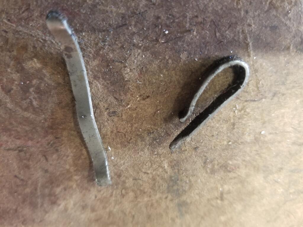

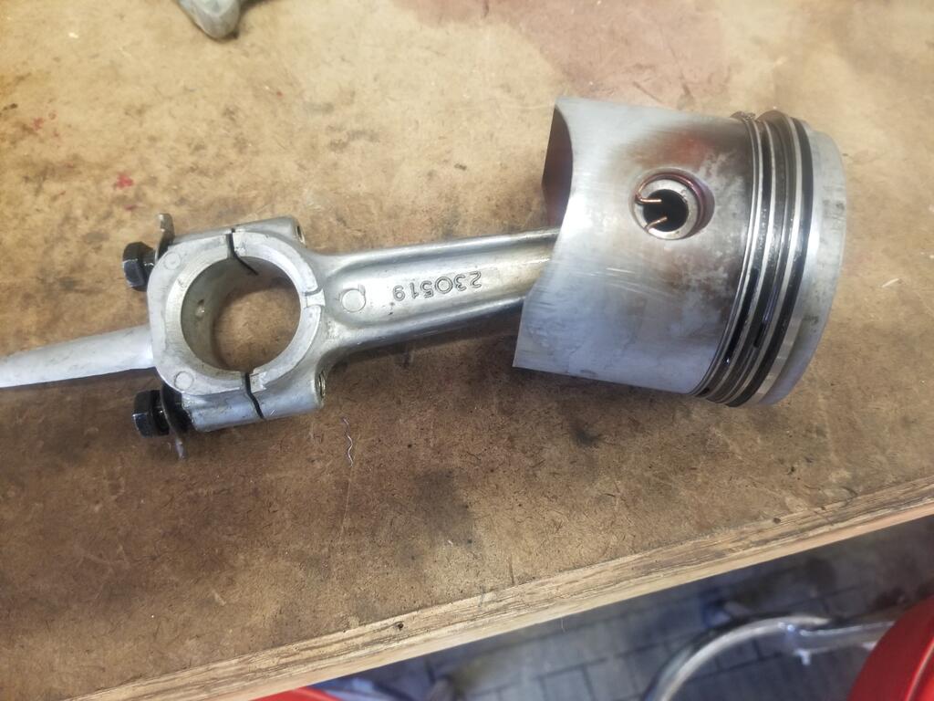

Elliot Garfinkel 166 #11 Posted May 25, 2020 Hi guys at the bottom of the oil pan found these 2 pcs of aluminum looks like they came from rod assembly, I'm not sure if they are supposed to act as a paddle or they act as a lock . Thanks again for your continued help Share this post Link to post Share on other sites
richmondred01 2,333 #12 Posted May 25, 2020 Well now that's something new. Thats not from the rod and shouldn't be in there. Share this post Link to post Share on other sites

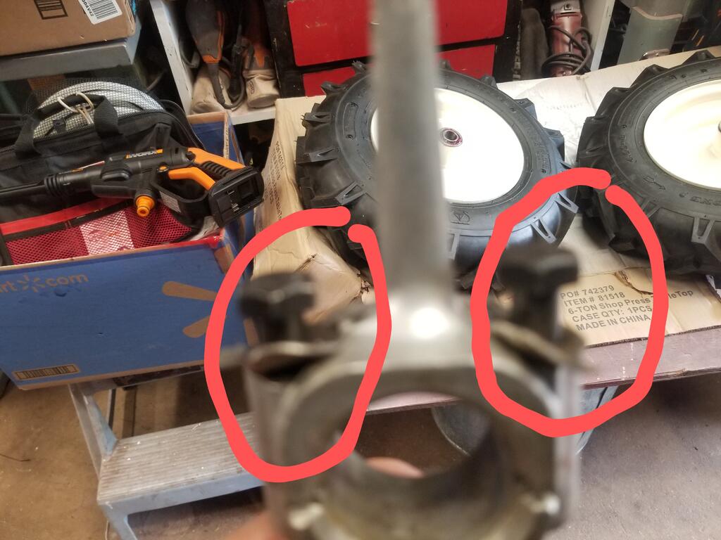

Elliot Garfinkel 166 #13 Posted May 25, 2020 (edited) I'm not sure if you can tell from pic but at the 2 bolts the ends look like it broke off of those two ends Edited May 25, 2020 by Elliot Garfinkel Forgot pic Share this post Link to post Share on other sites
richmondred01 2,333 #14 Posted May 25, 2020 (edited) Ok. Makes sense now. The photo is deceiving. It's the lock for the rod nuts. they look larger then they really are Edited May 25, 2020 by richmondred01 Share this post Link to post Share on other sites
Elliot Garfinkel 166 #15 Posted May 25, 2020 Ok thanks so the new ones have it and after the nuts are tightened (torqued)they get bent to lock the nuts.Do they usually break off or was it hitting the bottom of the pan. Thanks again for your help Share this post Link to post Share on other sites
richmondred01 2,333 #16 Posted May 25, 2020 Only if you have a NOS Kohler. after market ones have bolts not nuts. Share this post Link to post Share on other sites
