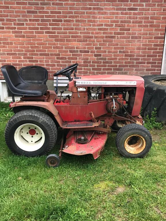

Pollack Pete 2,273 #1 Posted May 24, 2020 (edited) Just removed the extremely rotted 48 in deck on my C-161 yesterday.Put on a new,used 42 in side discharge.Anyone know off the top of their head what drive belt I need?Either belt length or WH part number?I have several new WH belts here ,but I wasn't smart enough to label them when I bought them over the years.BTW,this C-161 is the Horse with the metal hood.Not the plastic hood one,if it makes any difference for the belt.Here's a pic of the tractor.Thanks for any help. Edited May 24, 2020 by Pollack Pete Share this post Link to post Share on other sites
gwest_ca-(File Mod) 11,888 #2 Posted May 24, 2020 The belts have been added to this parts page. Click on the fuzzy picture to see them. May not be the deck model you have but the belts will be the same. Garry Share this post Link to post Share on other sites
peter lena 9,609 #3 Posted May 24, 2020 belts are usually , 95 1/2" on rear discharge , and 103 " on side discharge . pete 1 Share this post Link to post Share on other sites
daveoman1966 3,881 #4 Posted May 24, 2020 OEM BELT 102742 or 94-2501 103" x 0.5" 1 Share this post Link to post Share on other sites
