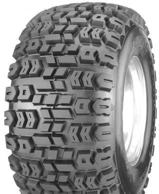

71_Bronco 1,072 #4 Posted May 21, 2020 I put a set of Kenda Terra Trac K502's on my Commando 8. The tires were originally bought for another WH, but I decided to put them on my Commando. I wanted something a little more aggressive than turfs, but didnt want ags. I also wanted a tire that would be the same on all 4 corners (OCD kicking in). The rears are slightly larger than the stock tires, but I think they look really sharp. I'll have to take a picture of the tires on this weekend. Share this post Link to post Share on other sites

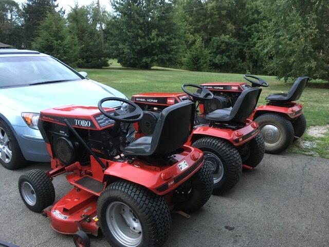

tom2p 2,394 #5 Posted May 22, 2020 (edited) I thought a 414-8 would have 9.50 width rear tire (not 8.50) - but I do realize some 400 and older 500 series tractors had 8.50 width 42 RD deck is compatible with a 520-H with 10.50 rear tires - so I assume there should be enough clearance for your 414 with 10.50 rear tires pic below of a 312 with 9.50 Titan rear tires and a 42 RD deck ; 10.50 rear tires would be 1/2" wider on each side ... ? ... so from this picture also it appears there should be sufficient clearance Edited May 22, 2020 by tom2p 1 Share this post Link to post Share on other sites
David414 311 #6 Posted May 24, 2020 Thanks for the info. I measured the clearance on my 42"RD deck to the stock 23 x-8.50 -12 tires and I have 1.25" of clearance, and the fenders have 1 5/8" and 1 /3/8" clearance. 1 Share this post Link to post Share on other sites

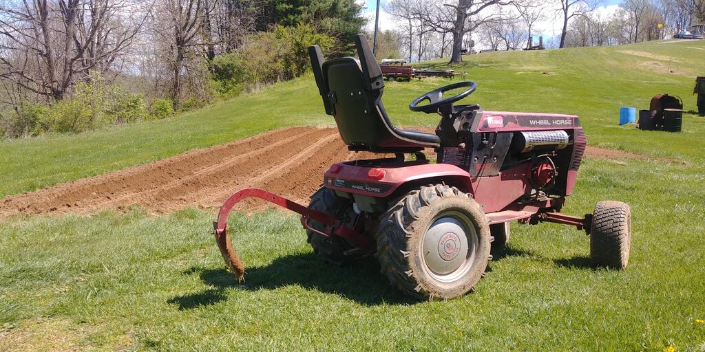

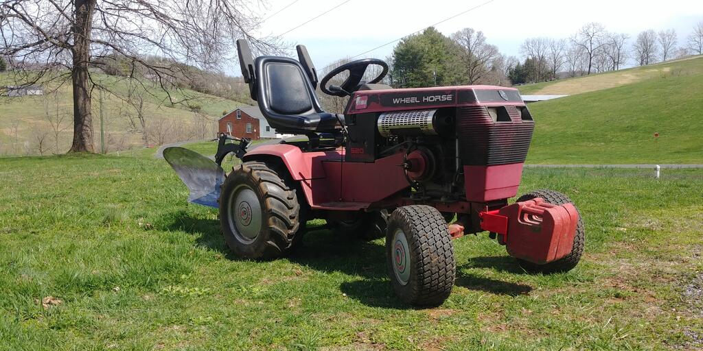

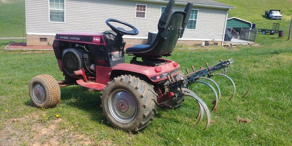

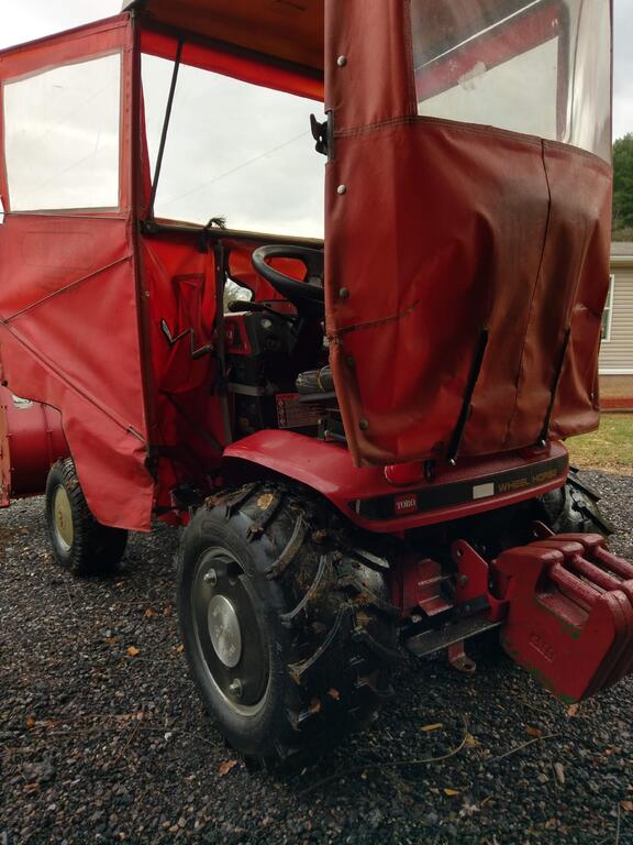

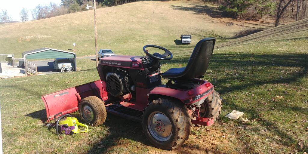

WVHillbilly520H 10,378 #7 Posted May 24, 2020 You should check out OTR tires...https://otrwheel.com/products/lawn-garden/... Or... https://otrwheel.com/products/powersports/... I have no problems with their Lawn Trac R1 fluid filled and steel weights and NO chains on my asphalt drive or grass all 4 seasons. 2 1 Share this post Link to post Share on other sites

David414 311 #9 Posted May 25, 2020 WVHillbilly, Awesome looking tractor! Your 520 has 8.5" wide rims? Mine only has 7". Trying to buy wider rims to run larger width tires. Questions, what size tires do you have ? How heavy are your wheel weights? Very Impressive suit case weight rack, is a rack system like yours still available for sale somewhere? Several members have stated that the AG's have very poor snow traction, especially in reverse? Is the pattern on your tires different from other AG tires allowing you to have better traction in the snow and in reverse? Many thanks for the info and the pictures! Share this post Link to post Share on other sites
WVHillbilly520H 10,378 #10 Posted May 25, 2020 21 hours ago, David414 said: WVHillbilly, Awesome looking tractor! Your 520 has 8.5" wide rims? Mine only has 7". Trying to buy wider rims to run larger width tires. Questions, what size tires do you have ? How heavy are your wheel weights? Very Impressive suit case weight rack, is a rack system like yours still available for sale somewhere? Several members have stated that the AG's have very poor snow traction, especially in reverse? Is the pattern on your tires different from other AG tires allowing you to have better traction in the snow and in reverse? Many thanks for the info and the pictures! Yes 8.5" wide rim, 55-60# steel weights plus 5 gals of methanol per tire, suitcase rack custom built by me, if you look closely at the tire the center tread is perpendicular to the tractor before it angles away there by in my opinion and observations since buying this brand no need for chains and no traction issues for me. 1 Share this post Link to post Share on other sites
