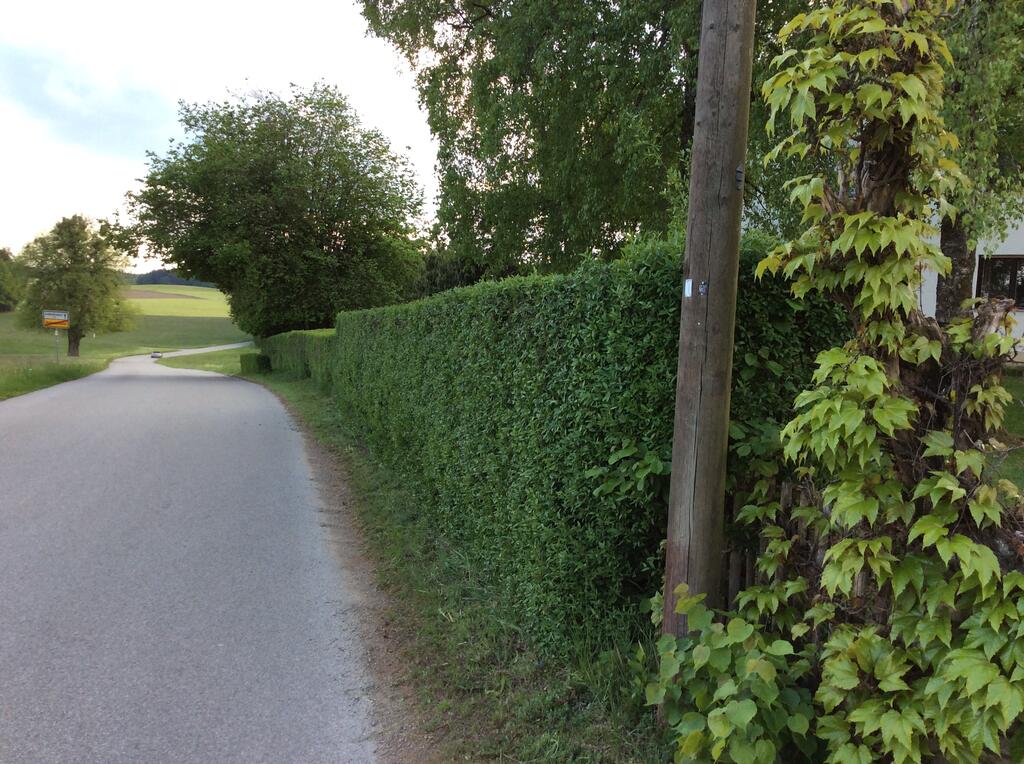

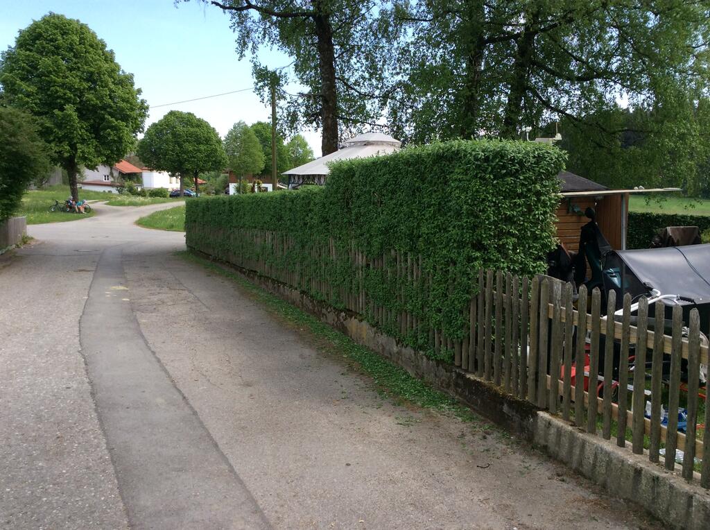

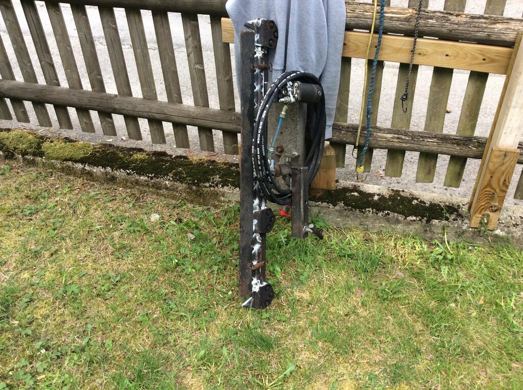

Tractorhead 9,217 #9 Posted May 19, 2020 I misused a Sicklebar to Trim the Hedge and save my Back. I reworked an old Sicklebar with 1,10meter in width for that. The Hydraulic System itself needs about 6-8 HP of the Engine to have enough Power to cut. i reduced a bit the Oilpressure for that Hydraulic channel down to 100 Bar instead the maximum of 176 Bar what is availabe at the Oilpump itself to limit the cutting size and to protect the system for Overload. That is a Pict of my Reworked Sickle it was a Danvoss Oilmotor doubleaction with 8ccm Flow. I mount an Oilmotor with 8ccm on it and build a separate Mount. it will be driven by a Hydraulicpump with 6ccm With the mount i be able to rotate it in every Angle between 0 -72Deg it works nice up to 3/8, thickness at all, than it begin to stall sometimes. But because of the bidirectional possibillity i just have to reverse the Oilflow on the controller and it Cuts completely. The actual rotationspeed of the Oilmotor is about 50- 80 RPM The result can be seen below. Trimmed Hedge on the Frontyard Trimmed Hedge along the Roadside. i thinkerin on a Hydraulic Level Upgrade, but i still also can use it how it is. Just the Top Cut wobbles a bit depending on the Sidewalk wobble. But no Backtroubles after cutting the Hedge further, so it‘s works for me. 2 1 Share this post Link to post Share on other sites
