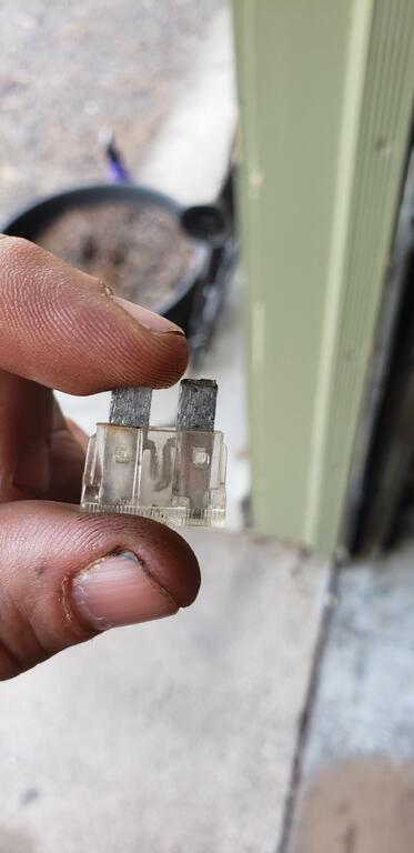

Jaydubz83 22 #11 Posted May 17, 2020 Reckon I found the electrical issue..... It was late and the lighting sucked last night so I didn't catch this Looking at a wiring diagram seems to show this (the 25A) fuse being linked to the starter and panel circuitry (if I'm sayin this correctly) So it would seem cranking the h-e-double hockey sticks outta Ol Ruby may have caused this fuse to blow maybe? I had to order some because this morning I blew a brake hose on my car and none of the 7 (yes 7) local NAPAs, VIPs, AutoZones, Pepboys and Advanced Auto stores had the hose I ACTUALLY need replaced (doing all 4 w the if one is shot the others are not far behind it mentality) This just ain't my weekend 😖😣 Stay tuned for more updates upon receipt of parts etc etc. I do wanna give a shout out to all the folks who threw baseline troubleshooting ideas my way. This NOOB really appreciates your expertise 👍👍 Joe 2 Share this post Link to post Share on other sites
