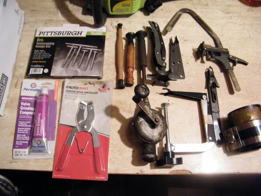

stevasaurus 23,617 #8 Posted May 16, 2020 Here is mine...picked up most from e-bay and HF. The valve spring compressor is a good one to have. Share this post Link to post Share on other sites

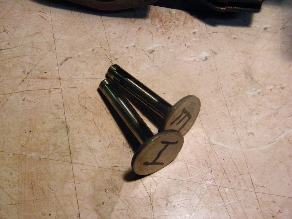

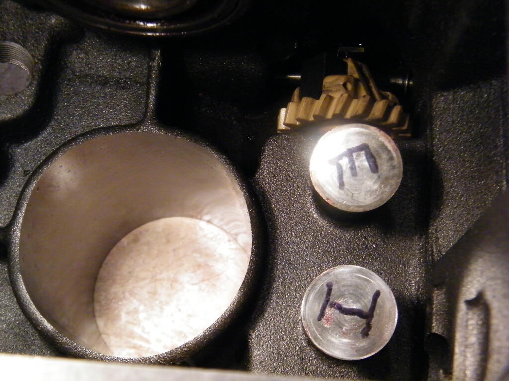

Slimshady 0 #10 Posted October 24, 2021 Hi do you know witch valve goes in witch hole had mine out didn't mark where they came out of and they are different in length thanks Share this post Link to post Share on other sites
stevasaurus 23,617 #11 Posted October 24, 2021 The larger one is intake, the smaller one is exhaust I'll bet you are talking about the tappets. With the tappets, you might be able to place and put in a valve and check clearance to determine which is which. Share this post Link to post Share on other sites
