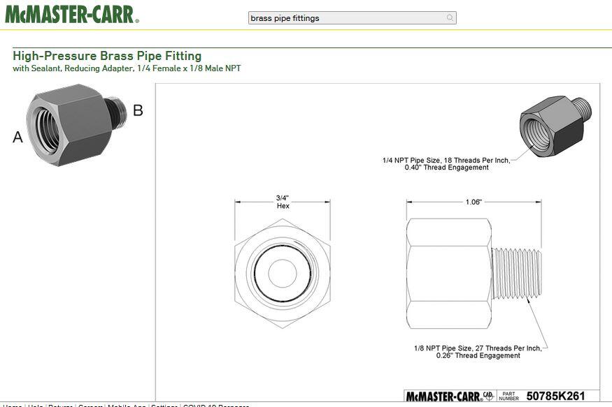

I have  KT1724363...I broke the brass fitting that the oil pressure sensor screws in to.  I cant find anything on line to help  Cant tell if its pressed in to the block or screwed in so I don't want to try an easy out until I know.  I cant find that part on line either.

Screwed in it should be 1/8" 27tpi in the block .What is the tread size of your sending unit?

The sending unit appears to be about 1/4 inch male thread.  I broke the adapter that holds that and threads in to the block.
pfrederi
Something like this is what you  need

that certainly looks like what it is.   Thank You!
