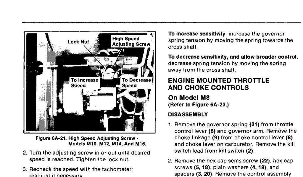

pfrederi 19,497 #5 Posted May 14, 2020 Manuals are very helpful.... 1 Share this post Link to post Share on other sites
oldlineman 1,626 #6 Posted May 14, 2020 Thank you pfrederi why didn't I think of that, sometimes we make it too hard I guess! Bob Share this post Link to post Share on other sites
oldlineman 1,626 #7 Posted May 15, 2020 Just an update adjusted RPM's very easy should have looked at it first was very obvious how to do. Thank you too all who responded have a safe week ahead. Bob 1 Share this post Link to post Share on other sites
