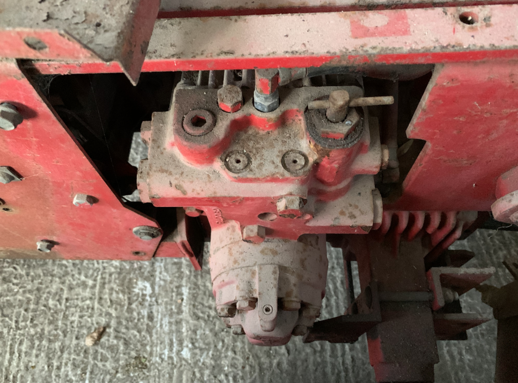

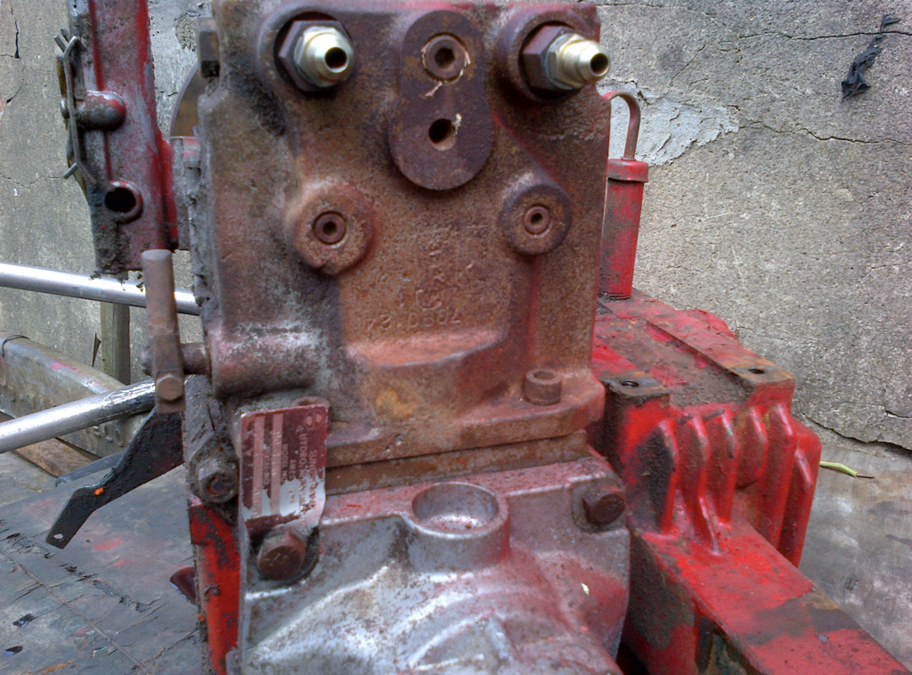

meadowfield 2,953 #1 Posted May 14, 2020 I've been a little slow, and not paid attention - my first GT-14 1-0502 - serial 907068 has the following transmission - which we pulled apart 8-9 years ago. Ports on the side and tow valve to the front - which locks tight. My second GT14, which doesn't run, 1-0502 is serial 907028 has the following transmission. Ports on the top and a tow valve that spins, but locks in one direction. Both were manufactured probably in the same week in the same factory. I doubt they made them with different transmission - so which is original to the year? Assume one has been replaced? Any GT14 experts shed any light on this? Share this post Link to post Share on other sites
953 nut 64,283 #2 Posted May 14, 2020 The second one looks like the hydrogear on my 1970 GT-14 Share this post Link to post Share on other sites
19richie66 17,819 #3 Posted May 14, 2020 Mine is a 72 and it had the transmission with the valve and fittings on top. Can’t help you with the serial number as mine had one that was unreadable. It is a 1-0502 model though. Share this post Link to post Share on other sites
pfrederi 19,944 #4 Posted May 14, 2020 Top one is a piston to piston hydro transmission not correct for a GT-14. Some one must have changed the input gear to make it work with a GT-14 transaxle unless they swapped out the whole rear end. Piston to piston units first appeared in the 18 Autos and some no-names. Then used in C series after that. 1 Share this post Link to post Share on other sites
meadowfield 2,953 #5 Posted May 14, 2020 (edited) 48 minutes ago, pfrederi said: Top one is a piston to piston hydro transmission not correct for a GT-14. Some one must have changed the input gear to make it work with a GT-14 transaxle unless they swapped out the whole rear end. Piston to piston units first appeared in the 18 Autos and some no-names. Then used in C series after that. I'm sure when I bought it, I had a manual that showed GT-14 with piston/piston. Also I thought later ones had it fitted - but i can't find anything. Whoever swapped it (I'm in the UK) did a good job if they did! I've mentioned it loads of times ands no one ever corrected me - Help am I going mad or did they fit both??? Edited May 14, 2020 by meadowfield 1 Share this post Link to post Share on other sites

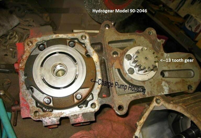

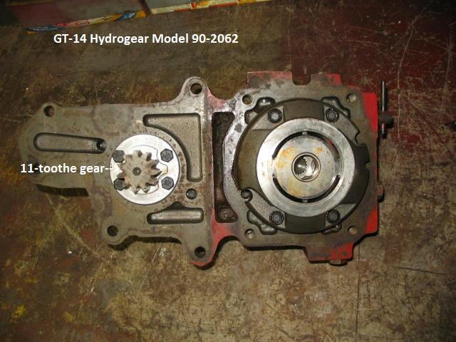

daveoman1966 3,882 #11 Posted May 15, 2020 The Sundstrand Hydrogear model for the GT-14 is 90-2062 and the 'drive gear' is 11-tooth. On the Sundstrand Hydrogear models 90-2046, that same gear is only 13-tooth. Here are the comparisons... 2 Share this post Link to post Share on other sites
