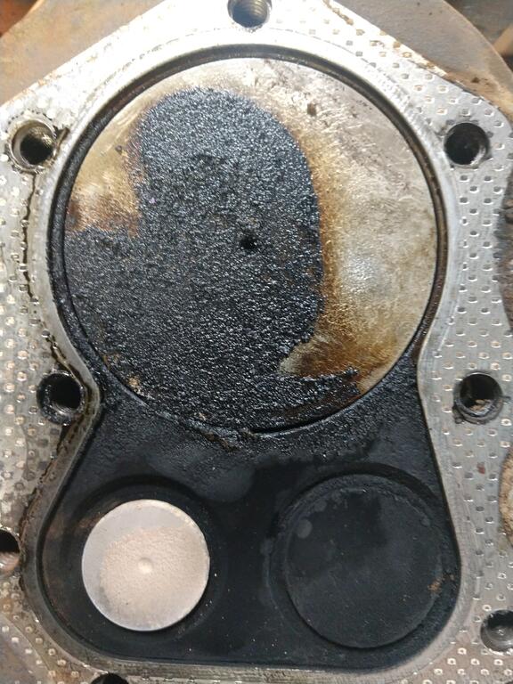

troutbum70 858 #12 Posted May 15, 2020 To start with I misunderstood my spark tester as I had never really used it before, it is a neon lamp and does not change colors. I do have an ok blue spark at the plug, and it did run but poorly. I had done a leak down test on it a while back and had a pretty good leak at the intake valve, it little into crank case which was expected and slight leak at exhaust valve. Today I pulled the carb which has its own issues, done a valve adjustment both were tight, then done another leak down still had a good leak at intake valve and about the same as previous at crank case and exhaust. So pulled the head, opinions please based on my pictures. I have not removed the valves as of yet, I can't at this point see any apparent cracks or damage. Cylinder bore is very clean, shinny, not scratch's or damage. Share this post Link to post Share on other sites

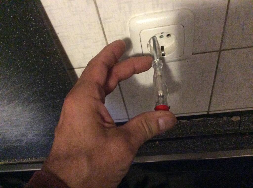

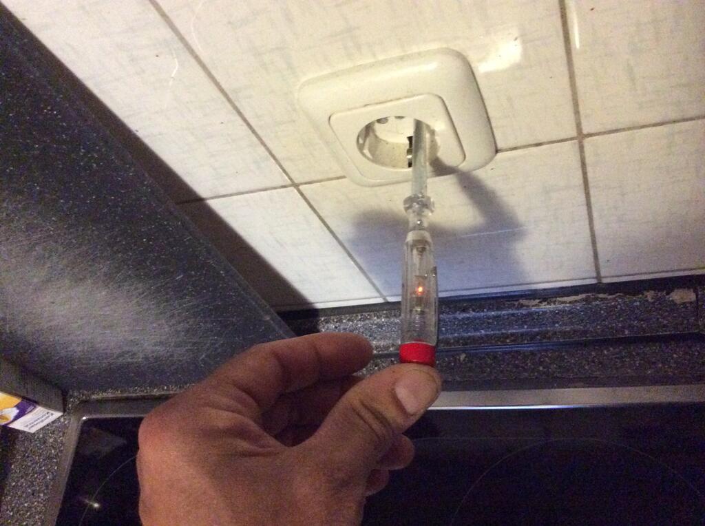

Tractorhead 9,217 #15 Posted May 15, 2020 That‘s the same as i meant in my answer. They be told here glimmer lamps. You can find them here in Screwdrivers as a quickcheck if Power is on the Line and on witch Side of the Connector the „hot“ Side is. And you can use them simply by put into Sparkplugconnector and tip the other side onto Ground to verify if the Whole ignition system works. but as i told before it is not a real measuring of the Power. This neon lights are acting beginning from about 60V AC. it just shows if a spark can be initiated but absolute no realistic answer about the Poweroutput of the Coil itself. For a Quick check if spark is still possible that‘s good enough. Share this post Link to post Share on other sites
