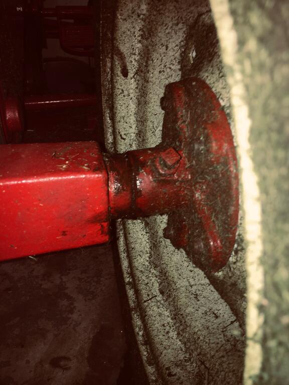

WH656 9 #1 Posted May 8, 2020 Hi All, Although I am so busy lately I dont get to visit or research a lot, I thought I would ask the great forum and great people here. I cant seem to find the part number or where to purchase a seal for my 1966 WheelHorse 656 that is leaking. Can anyone please help? I have included an image. Share this post Link to post Share on other sites
gwest_ca-(File Mod) 11,559 #2 Posted May 8, 2020 Here is a parts list 1232 should be WH axle seal number replaced by 100863. SKF/Chicago Rawhide available from Napa #9815 The 2nd picture here is for your model. Click on the picture. Garry Share this post Link to post Share on other sites
