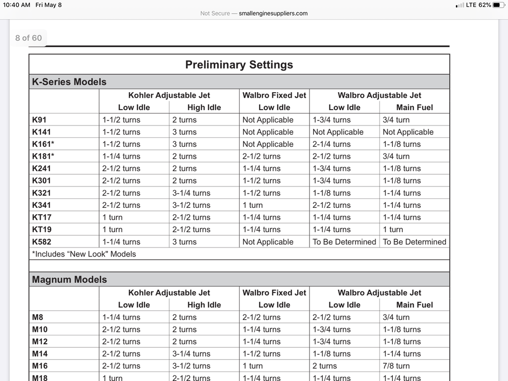

Pullstart 68,880 #2 Posted May 8, 2020 The top screw is your main, the 45 degree screw is your idle. Turn them in (clockwise) until they stop but don’t force them. Count turns out and adjust according to the K241 settings as a baseline. Here is a link for a good read 1 1 Share this post Link to post Share on other sites
