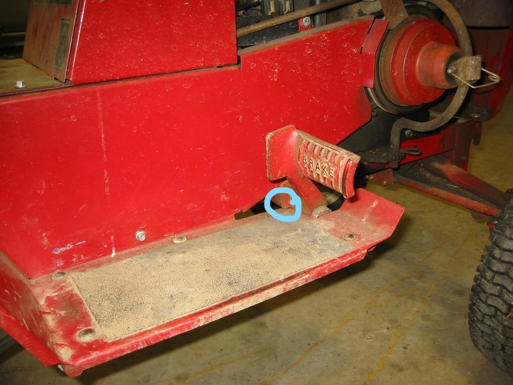

1988SS 50 #1 Posted May 7, 2020 The brake pedal flips rearward too far and the foot rest is bent downward. Is the right foot rest the limiting pedal stop or is there something in the linkage that prevents pedal 'flop back'? I had adjusted the brake so that the parking brake now engages and the foot brake holds. I'm not sure what the previous owners did to the linkage adjustment. Share this post Link to post Share on other sites
pfrederi 21,301 #2 Posted May 7, 2020 Brake pedal must catch the corner of the foot rest to hold it upright. 4 Share this post Link to post Share on other sites

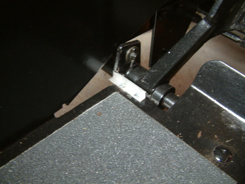

1988SS 50 #3 Posted May 8, 2020 That corner was bent down letting the pedal rearward. I installed a metal strip that will help support the pedal stop position. 2 Share this post Link to post Share on other sites

haydendavid380 759 #6 Posted December 24, 2020 Mine was the same way. Bent it back and it's been fine since Share this post Link to post Share on other sites
Stormin 9,988 #7 Posted December 24, 2020 I'd the same problem with the Black Horse. Fitted a piece of angle to the footplate. Share this post Link to post Share on other sites
