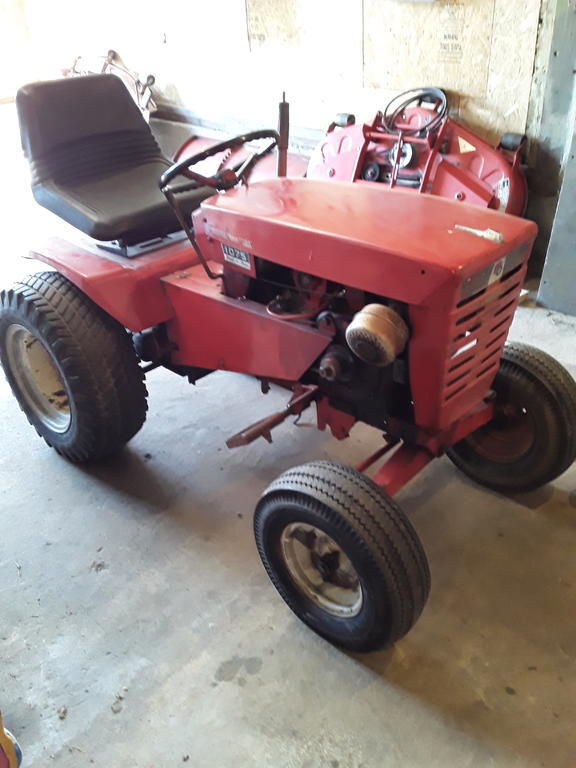

Pullstart 68,878 #9 Posted May 6, 2020 This is @76c12091520h’s picture from one of his hauls... (Happy Birthday too!) Sure looks short to me. 1 Share this post Link to post Share on other sites
ebinmaine 77,325 #10 Posted May 6, 2020 1075 is a short frame. Yes. It's the only big block short frame in the 60s series of tractors. The 10 horse pan is a smaller pan and there's no dipper on the connecting rod to make up for the loss of space. 10 minutes ago, kasey54 said: I also think its the last short made. It's the last and only short, with a big block. After that, 6 or 8 horse only on a short frame tractor. Share this post Link to post Share on other sites
