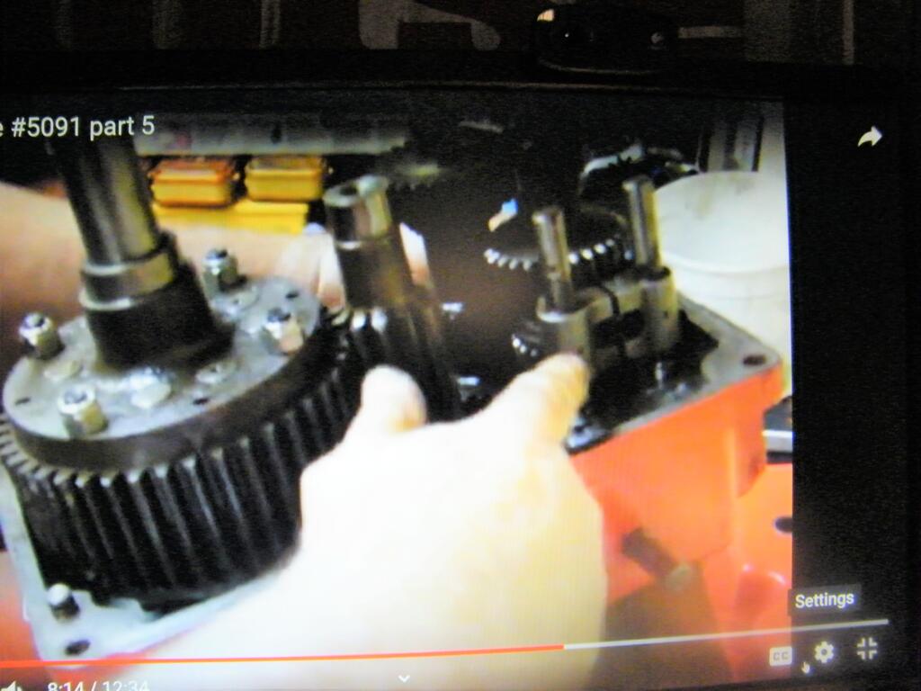

stevasaurus 23,620 #6 Posted May 5, 2020 Elliot, I'm confused by your statement. You cannot be in 3rd & 2nd at the same time. You can be in 1st & 3rd at the same time, but only if you have the shift rails were both are in gear. Do you have this square from the 2 shift rails?? If not, remove the shifter, take a large screwdriver and move the shift rails so you have this square. This will solve your problem. You are in 2 gears at once...put both shift rails in neutral. The picture shows neutral. Share this post Link to post Share on other sites
