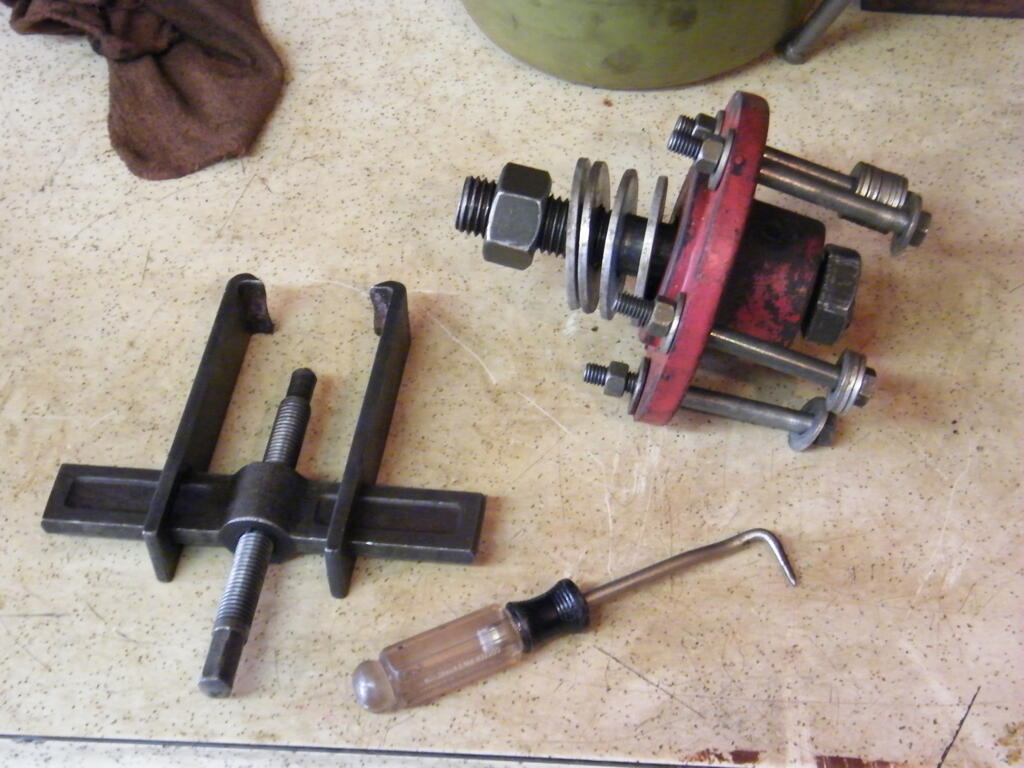

stevasaurus 23,536 #6 Posted May 3, 2020 Glad you posted here...thanks. The seal is Wheel Horse 6449 crosses to SKF 11124. The carter pin puller is at the bottom right. Use something like this to dig out the seal. Share this post Link to post Share on other sites

WH656 9 #9 Posted May 9, 2020 (edited) EXCELLENT info here. I will be wiggling that shaft yo check for play. Figured I'd reply here.. Just watched a video on the TUBE explaining the replacement of WH axle seal (I have a 656). Someone in the reply thinks the gy put the seal on backward!? So let me try to draw a diagram here with my keyboard: Trans: |--------|----shaft----[ <--- seal <-- which direction does the seal go?? The guy on youtube had it in with the open side out where you can see the open part of the seal as you are placing it on the axle...if that makes sense.. Secondly, do you always need a puller to get the hubs off? Edited May 9, 2020 by WH656 Share this post Link to post Share on other sites
stevasaurus 23,536 #10 Posted May 9, 2020 @WH656 put the Y-Tube URL in here so we can see. The open rubber faces in when you replace a seal...always! No, you do not always need a puller to pull off the hubs. Consider your self lucky when you don't. The scale goes from them falling off to cutting them off. No Kidding. Share this post Link to post Share on other sites

stevasaurus 23,536 #16 Posted May 20, 2020 The guy in that video did put the seal in backwards. The rubber always goes in toward the trans. Share this post Link to post Share on other sites
