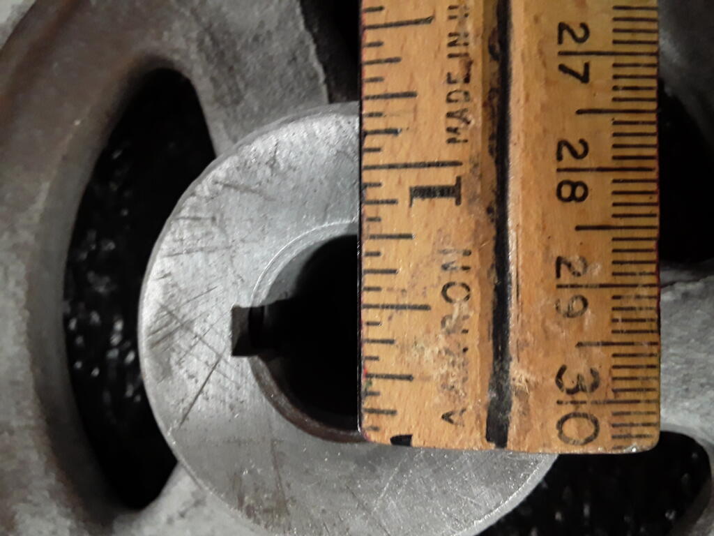

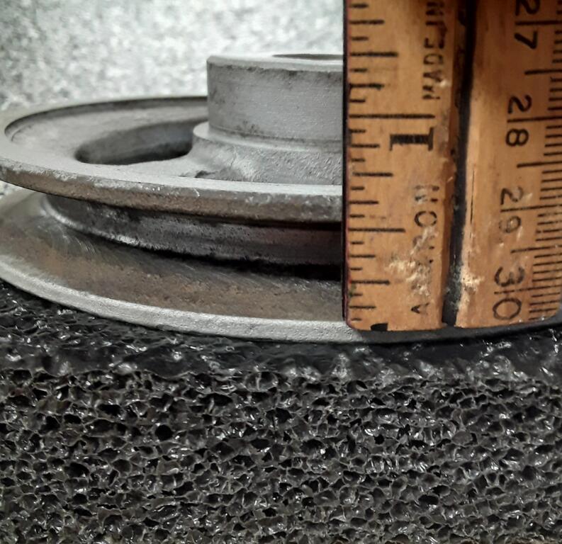

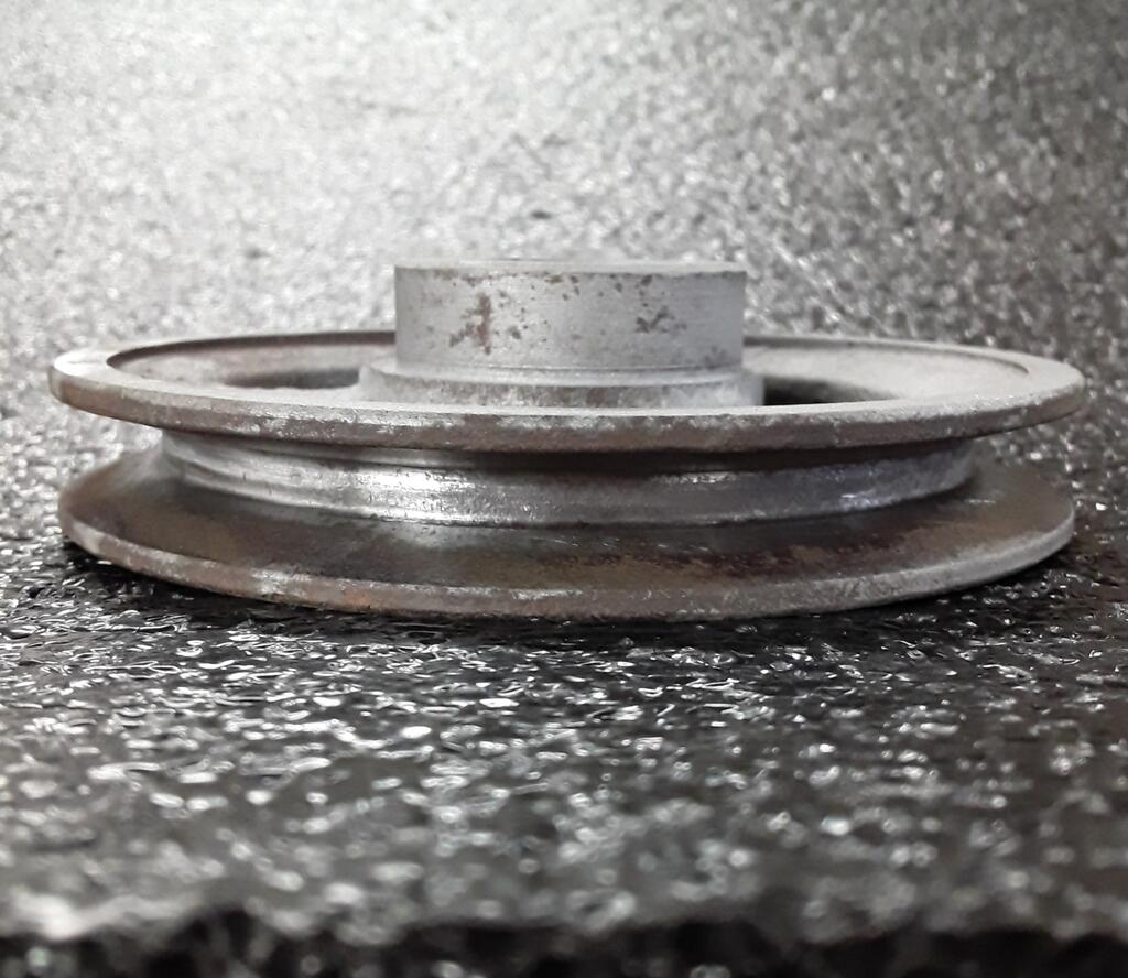

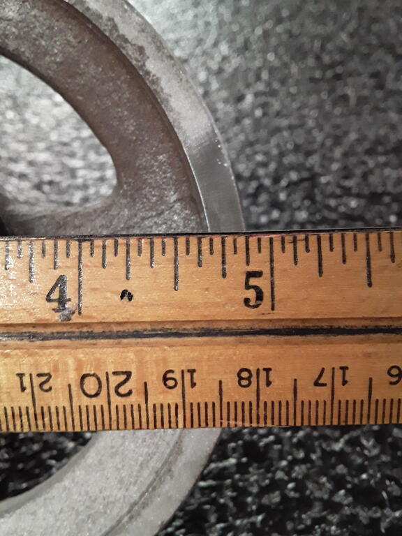

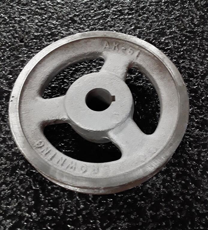

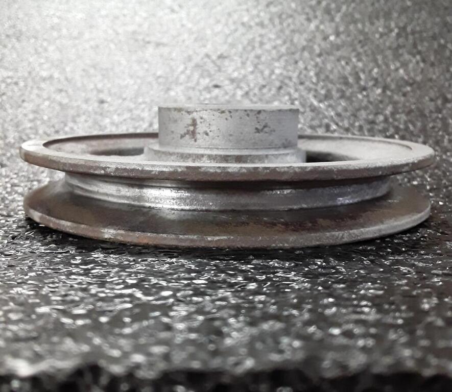

 A few weeks ago I brought home a load of parts and have organized and cataloged 99 % of them; now I'm down to the unknown . I'm not even sure if this is a W. Horse pulley or not. It matches nothing we have in stock or on any of our equipment. It measures 4 7/8" in dia. , has a 3/4" dia center keyed hole, and would take a 1/2 belt.  It is not cast with any #'s on it. There were remnants of red paint on it , and there was nothing in the parts haul that wasn't WHorse. Let me know what we might have here. Thanks :eusa-think:
WHNJ701
it looks like a generic pulley made by browning
  • Like 4
  • Excellent 1
ebinmaine
1/2" drive belt would normally be pre 67 or so but I don't know what engine would have a 3/4" shaft.
Older smaller... Maybe 3 - 5 horse engines?
Agreed.
Maybe a replacement for a worn out one many moons ago.

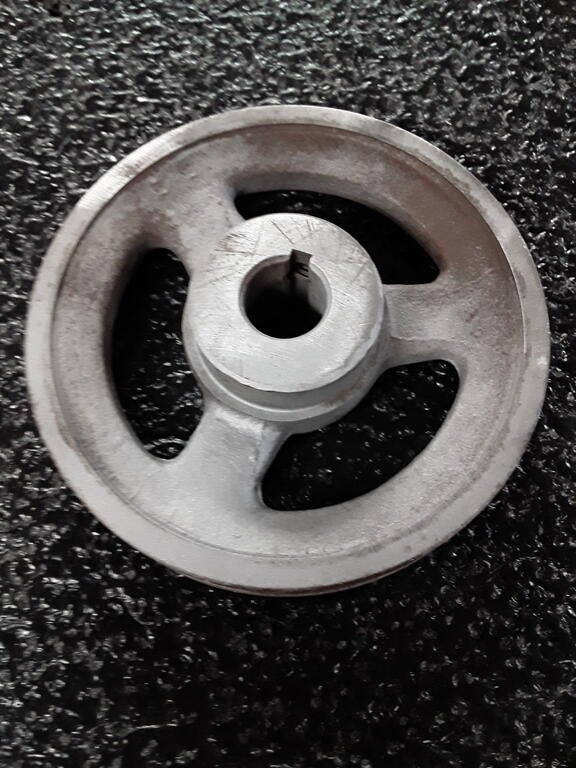

daveoman1966
Instead of an ENGINE pulley, I'm thinkn' it may be a TRANNY input shaft pulley...  Maybe???
  • Like 2

ebinmaine
Did the early ones have a larger shaft?
I'm only familiar with maybe 65 and up.
Retired Wrencher
It reminded me of an old Auto trans pully?

Browning is an industrial manufacturer and this probably isn't for a wheel horse. It could be used on the input shaft of a manual transmission with a 3/4" shaft.
prondzy
Looks similar to a trans input shaft on a 953/1054, or the jackshaft on a rmr36 in mower deck.
stevasaurus
The 3 piece and the 3 speed transmissions used a 3/4" input shaft.  That pulley would work but is different from what the original looks like.  :orcs-cheers:
kasey54
Maybe for a snow blower shaft
