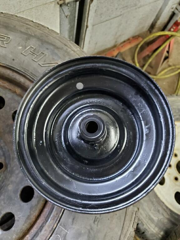

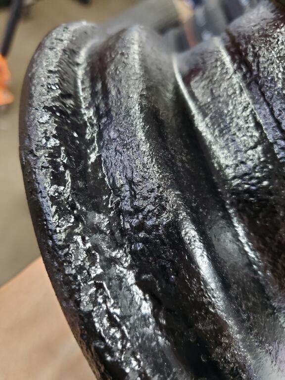

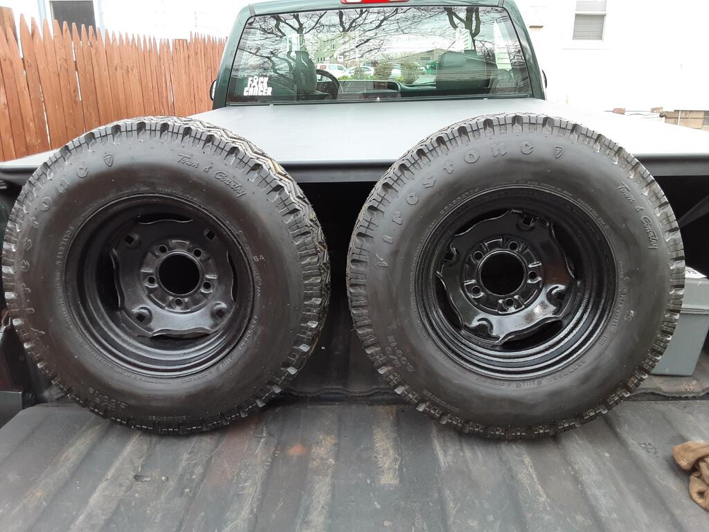

D_Mac 9,339 #115 Posted May 15, 2020 Well I finally got him to send me photos of the progress on my tires and wheels. Took the tires and wheels to my Nieces husband business. He told me he had some tires for the rears and I ordered a pair for the front. He said he give me the rears, and mentioned he wanted to get rid of all this tires. I told him I am interested but have yet to get a number from him. Im working on it. Anyways here they are, he still is working on the front as the rims were in bad shape. He gonna try to get tubes for them. I wanted to paint them white but all they had was black. So he painted them black. They are still pitted and it shows through the paint but they look way better and I didnt have to do it ! So hope fully I get them back soon with a price on the tires. 4 2 Share this post Link to post Share on other sites
D_Mac 9,339 #116 Posted May 15, 2020 Ummm I just noticed I think he has them mounted backwards. 1 Share this post Link to post Share on other sites

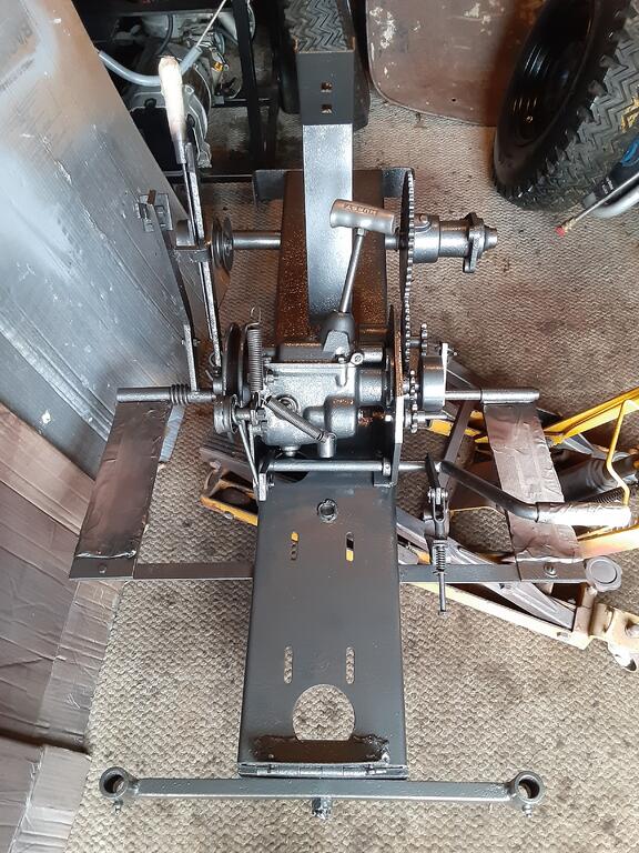

D_Mac 9,339 #117 Posted May 15, 2020 Ordered new chain, and those shaft collars off the old internet. Couldnt find the closed end kind so I got the open ended ones. I am not sure what I need for the front end besides new tie rod ends. The spindles slide into the ends on the axle. I think I need some kind of bushings or washers. I am not sure what they are all called or wear to get them. The shaft size is 7/8ths. Washer and bushing on top and bottom? Put a coat of primer on the frame today. Would like to get the front end assembled so I can put it on the ground when the wheels are ready. 4 Share this post Link to post Share on other sites

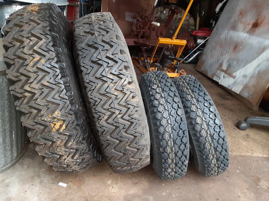

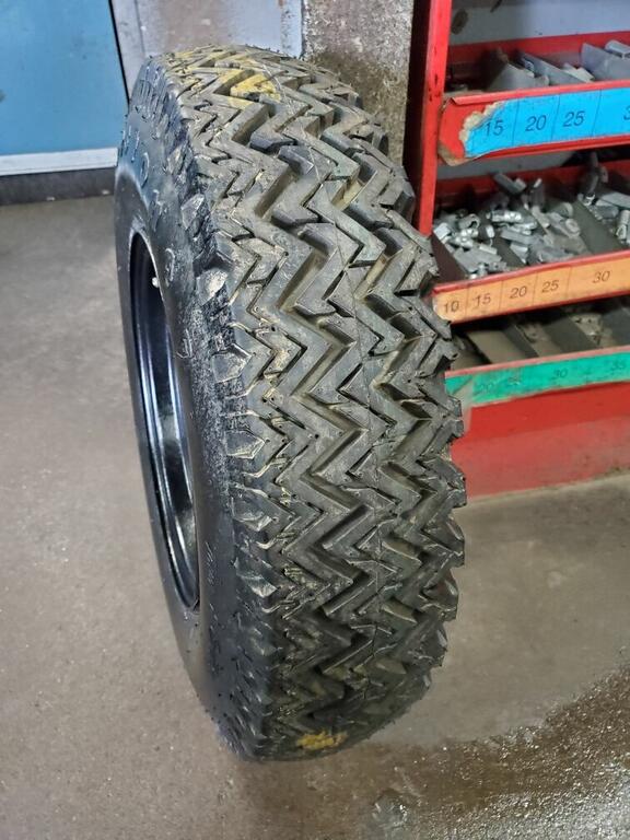

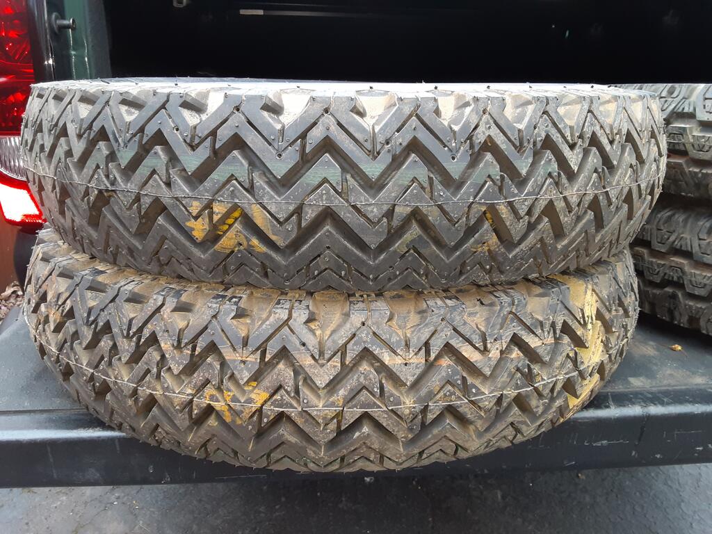

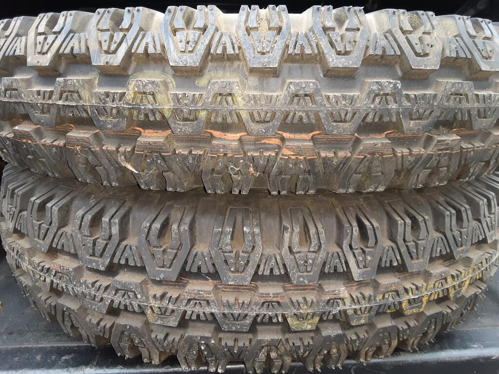

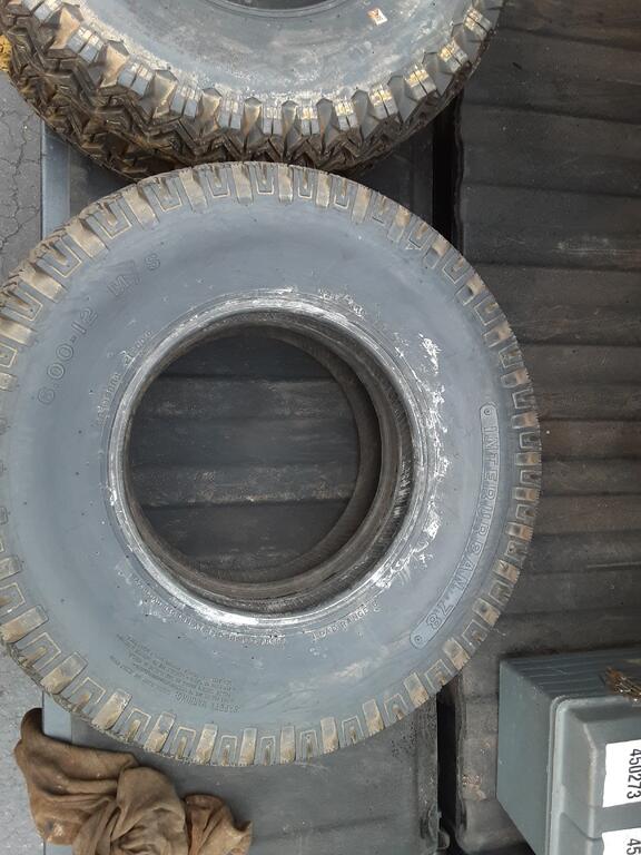

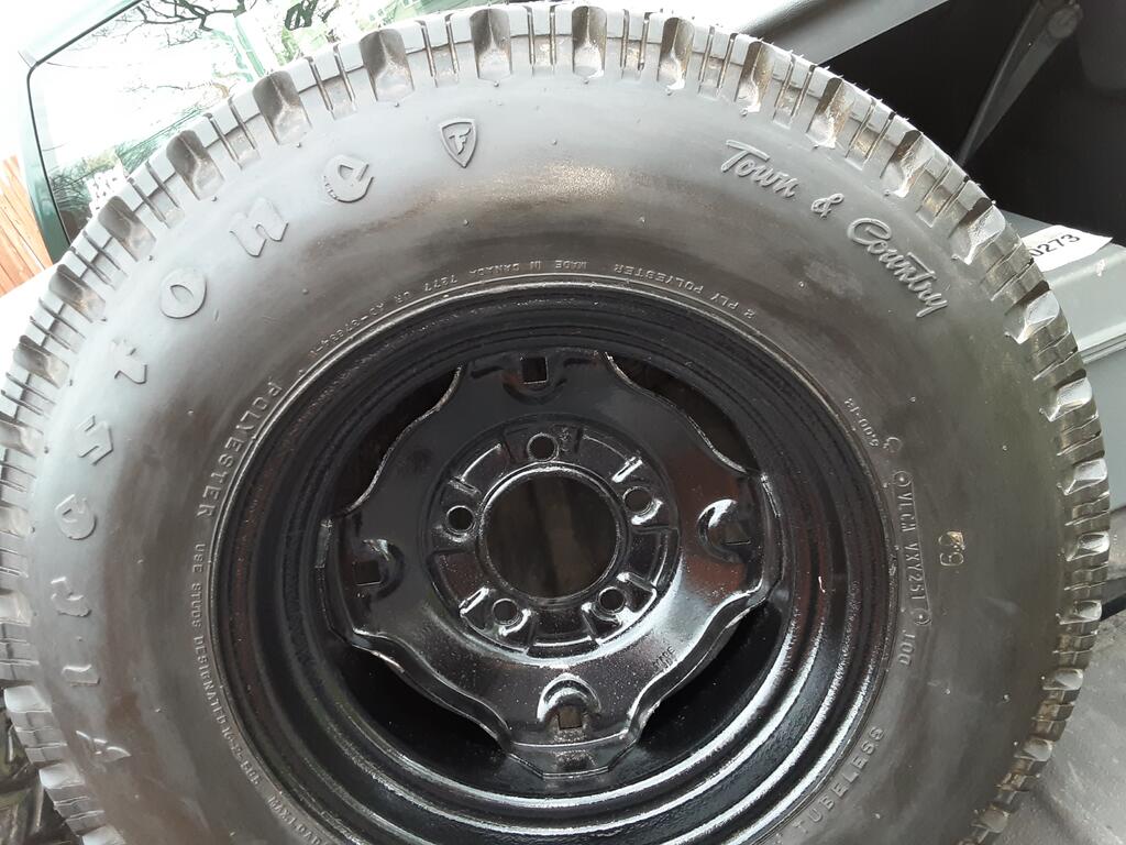

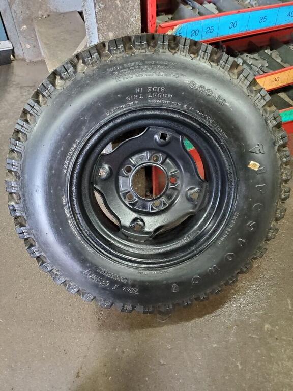

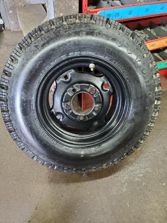

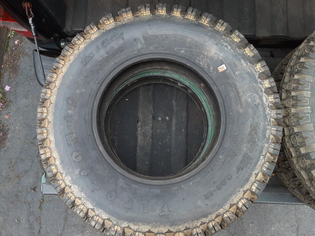

D_Mac 9,339 #118 Posted May 15, 2020 (edited) Well I went to pick up my tires and wheels. Im happy with them. I couldnt beat the price ! He gave me 2 pair to sell. The one pair is the same set I got for the rears. Firestone Town & Country 6 x 12 M/S and the other pair are Interurban 78 6 x 12 M/S. Tires are NOS. Not exactly sure how old I didnt ask, other then being dirty there is nothing wrong with them. Not sure what they are worth or even how to ship them. Thoughts? First 3 photos are my tires. You can use my set of Firestones so what they look like cleaned up. The photos after are they extra sets he gave me to show. They are dirty as they have been sitting in storage a number of years. Forth and fifth pic is the Interurban's Six and seven are Firestone. My understanding is Interurban is Firestone as well. Edited May 15, 2020 by D_Mac 4 1 2 Share this post Link to post Share on other sites

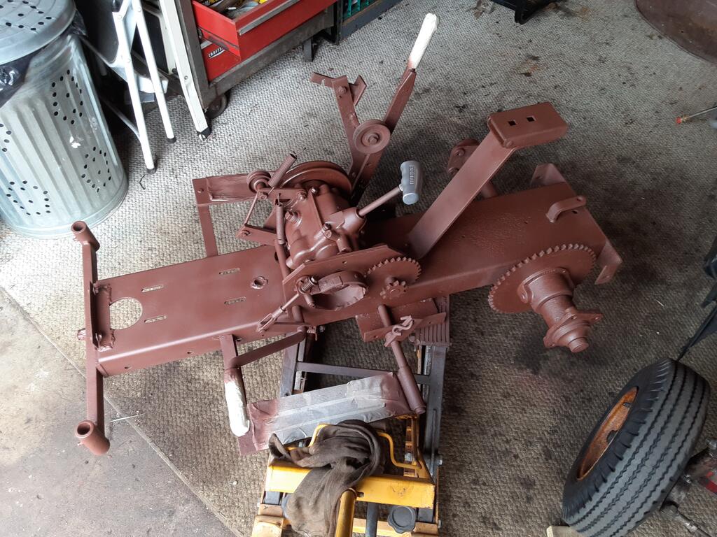

D_Mac 9,339 #119 Posted May 16, 2020 Laid some paint down on the frame this AM . I suck at this. 2 Share this post Link to post Share on other sites
ebinmaine 80,481 #120 Posted May 16, 2020 Looks fine from here. Light layers is important. 1 Share this post Link to post Share on other sites

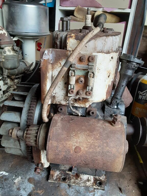

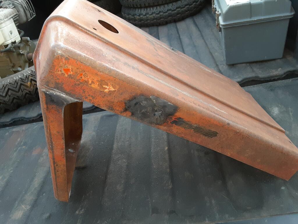

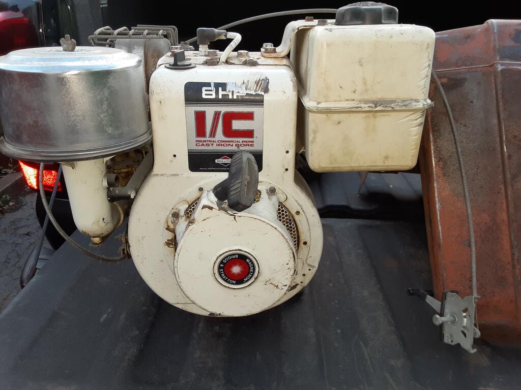

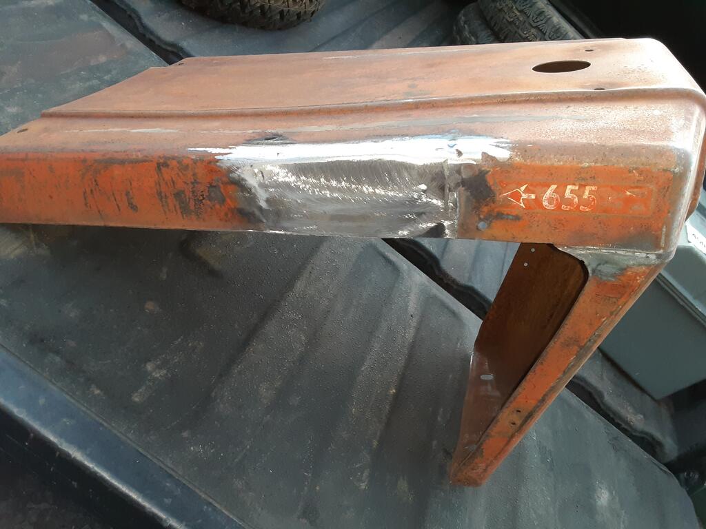

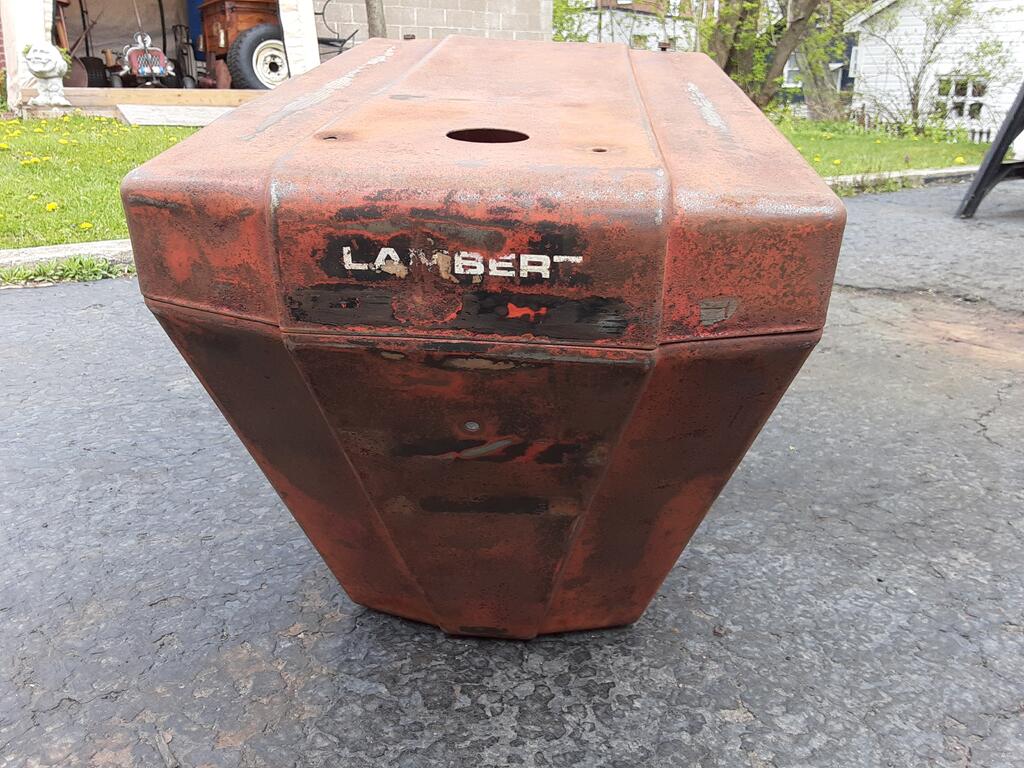

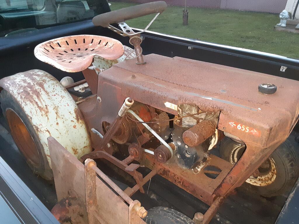

D_Mac 9,339 #121 Posted May 17, 2020 After I put some paint down on the frame I headed out to Tractor Supply to look for the wheel bolt and the shaft collar. No luck on the wheel bolt and like a dummy I grabbed the wrong size collars. Thats what happens when you get old and dont write it down. Tractor Supply is like 20 mins away so I guess I will keep them for now. After that my cousin called and said he could work on the hood for me and come get the engine he was donating. At some point in the Lamberts life time someone cut a section off the side of hood and looked like what appeared to be a bullet hole on the other side. So I loaded up the truck with the body parts and off I went. The engine has been sitting in his garage for 15+ years. 8hp Briggs. Hope it is going to fit under the hood and I can get pulley for the shaft. I brought all 4 body parts. He patched the holes and welded the corners on the hood. He pounded and smoothed out a pretty good dent on one of the rear fenders. He made two side covers that were missing on the body-dash . In the old photo you can see where it was cut and where the missing panel should have been. I didnt want to set the engine on the fresh paint yet to see what Im working with. This engine is a little taller then the one I took out. The gas tank that was on the tractor was a metal tank that mounted on the underside of the hood. Would like to find another on, looked on ebay but didnt see any. Now I can get the rest of it in primer and try to find some bushings and tie rod links for front axle. Thats giving me some trouble. Need to get it off the jack so I can roll it. 1 1 1 Share this post Link to post Share on other sites

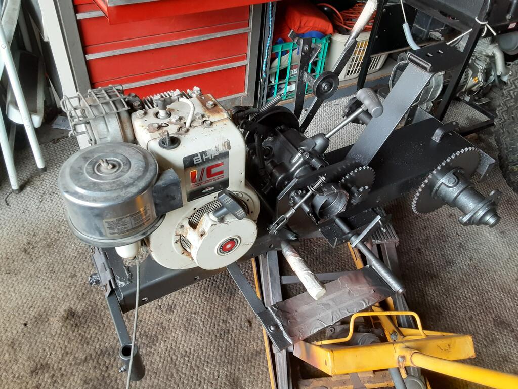

D_Mac 9,339 #123 Posted May 17, 2020 OK guys here is where I am going to need some help. I placed the engine on the frame and grabbed the hood to see if it was going to fit and it dosnt. With the gas tank on it is to tall. Is there a way I can rig up a fuel pump so I can place the gas tank where the battery was. This engine has no electric start and cant run lights or anything. Does the fuel pump run with a vacuume? Is there any way to put a fuel pump on this engine? Briggs 8 hp has the updraft carb. Or am I forced to mount the gas tank on the side of the hood like it is on the Speedanza. Or look for smaller engine. Perhaps a Harbor Freight special. Share this post Link to post Share on other sites
953 nut 68,912 #124 Posted May 18, 2020 6 hours ago, D_Mac said: Does the fuel pump run with a vacuume? Is there any way to put a fuel pump on this engine? A vacuum fuel pump will do the trick. just need to connect a rubber hose to the crankcase so the pulsations caused by the piston going up and down will cause the pump to pulse. You can get one for about $ 10.00. 1 1 Share this post Link to post Share on other sites
D_Mac 9,339 #125 Posted May 18, 2020 (edited) Not sure I am comfortable with drilling into a crank case. Looks like I need to drill something though. I looked up the specs on the 6.5 hp Predator engine. It says it has about a 2.5 inch length shaft. I measured the shaft on the original engine and its 3 inches. So to keep the pulleys lined up i would need to drill out some new holes in the frame to mount the engine a little more to the right. So I think my choices are drill holes in the hood and make up a mount and mount it on the side of the hood. Drill into the crank case and mount a pump and install the gas tank where the battery was. I am undecided. Not sure what would be best option. There is another option but I think its the most expensive. I was looking at the original engine, it has compression, but it most likely will need a new carb, the gas tank was like swiss cheese I looked online for another and no luck. Then I would need to mount a new one somewhere, maybe new points.. ect. It does have electric start but I dont even know if it works. Has these glass fuses mounted on the engine, I never seen anything like that before. The pull start needs rebuilding. So thats why I am not even considering it < kinda > Edited May 18, 2020 by D_Mac Share this post Link to post Share on other sites
