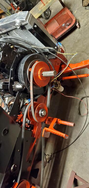

wh500special 2,437 #29 Posted May 6, 2020 Very nicely done. Excellent detail. I'm guessing it's in the build pictures, but what is the driven pulley near the right side footrest? Steve 1 Share this post Link to post Share on other sites

John Voss 76 #31 Posted May 7, 2020 (edited) 5 hours ago, wh500special said: Very nicely done. Excellent detail. I'm guessing it's in the build pictures, but what is the driven pulley near the right side footrest? Steve Due to the width of the engine, I had to use a Jackshaft to connect the engine to the transmission. Since the engine runs at lower RPM I was also able to gear the Jackshaft with different size pulleys to match the factory transmission input speed based on 3600rpm of a gas engine even though this engine only revs to just over 3k Edited May 7, 2020 by John Voss 4 3 Share this post Link to post Share on other sites
wh500special 2,437 #32 Posted May 7, 2020 Clever. Thanks for satisfying my curiosity. I thought maybe it was a for a live hydraulic pump or something, but I can see the width issue was the driver for this. Nice improvisation. I have an LGT14D and it is a pleasant engine to listen to. Probably a nice combination for a big 520. Steve 3 Share this post Link to post Share on other sites
