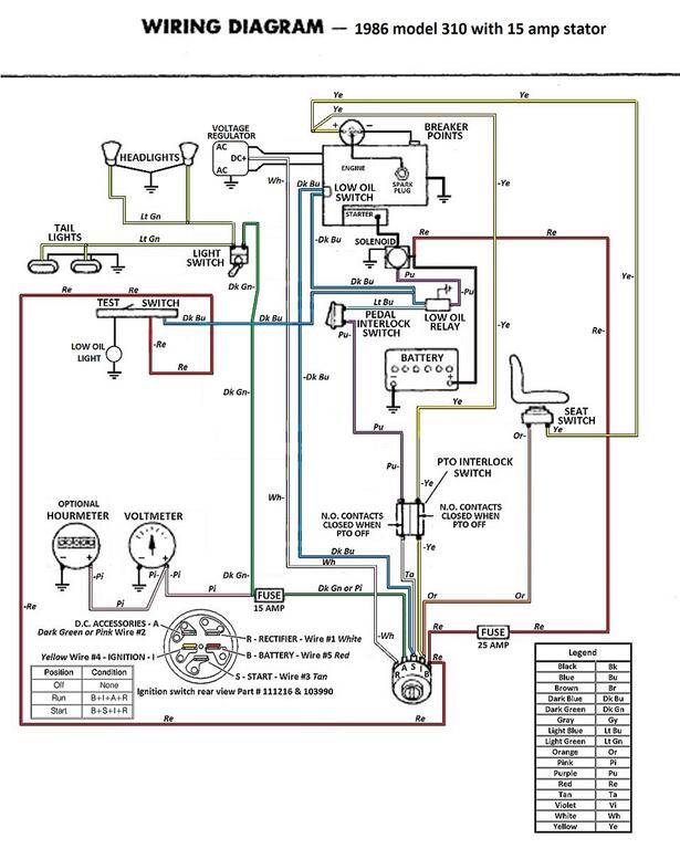

gwest_ca-(File Mod) 12,070 #4 Posted May 1, 2020 Sounds like your tractor's charging system has been upgraded to a 15 amp regulated system. The 46863 spec number is correct for the 1986 310-8. Take a look at this diagram and see if it looks the same. Pay attention to the pto switches to the right of the battery. If they are the same we are getting close. Let us know what you find. Currently working on a better wiring diagram but not fininshed yet. Garry 1 Share this post Link to post Share on other sites
gwest_ca-(File Mod) 12,070 #5 Posted May 1, 2020 Added what I have so far to the above link as it is easier to look at. The 310-8 does not have the idiot lights that are in the diagram. Just disregard to wiring to the circuit board connector from each switch. These tractors will work without the circuit board plugged in which is a great feature. Will work on removing the circuit board wiring so we have a diagram representing then 310-8. Garry 2 Share this post Link to post Share on other sites
johnnymag3 2,643 #6 Posted May 2, 2020 I will be working on the Horse this morning, thanks for all of the great info. I reviewed all of the diagrams, and it does appear that this machine has been upgraded to a Stator and a rectifier as you just mentioned. I will be checking my system with my DVOM and letting you kind folks the outcome. thank you !!!!! 1 Share this post Link to post Share on other sites
gwest_ca-(File Mod) 12,070 #7 Posted May 2, 2020 Changed the file in the above link to the modified 15 amp system so you can download and print if needed. Garry 1 Share this post Link to post Share on other sites
johnnymag3 2,643 #8 Posted May 2, 2020 That's exactly what I needed....Im making a new harness with all of the correct wire color and gauge. The diagram is perfect ! Thank you so very much, John Share this post Link to post Share on other sites

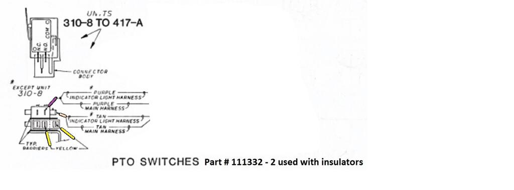

gwest_ca-(File Mod) 12,070 #10 Posted May 2, 2020 Here is another shot that may help. The pto switches came be confusing without it. It is also on this page as a pdf if you want to print or enlarge it. Garry Share this post Link to post Share on other sites
Bill D 2,678 #11 Posted May 2, 2020 Make site the regulator has a good ground wherever you mount it. You may also want to switch to a newer style regulator and mount it in the blower housing for cooling. Just my two cents. Bill Share this post Link to post Share on other sites

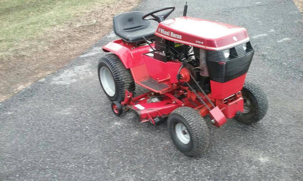

johnnymag3 2,643 #12 Posted May 3, 2020 (edited) Tractor is all done......entire harness complete. Engine has a stator ...as AC current was 9.7 to 14.7 depending on engine rpms.to the regulator. Thank you all for the info and extensive research you provide. The tractor was self guarded during repairs. Edited May 3, 2020 by johnnymag3 1 Share this post Link to post Share on other sites

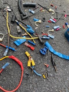

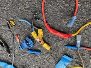

johnnymag3 2,643 #14 Posted May 3, 2020 This is what not to do or use when taking care of a Wheel Horse. Gotta love the 3 eyelets tied together with a rivet. Share this post Link to post Share on other sites
ebinmaine 77,825 #15 Posted May 3, 2020 46 minutes ago, johnnymag3 said: what not to do or use when taking care of a .... ANYTHING !!!! Aaaaggggghhhhhh...... 1 Share this post Link to post Share on other sites
johnnymag3 2,643 #16 Posted May 3, 2020 48 minutes ago, ebinmaine said: surprised I did not find any house wiring wire nuts !!!! 1 Share this post Link to post Share on other sites
