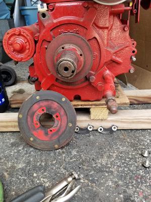

cafoose 3,836 #1 Posted May 1, 2020 How do I remove the pulley and bearing race from this point? I am putting a manual PTO on my GT-14. I have the electric PTO removed and there are no holes to attach the clutch plate so I'm assuming I need to change the pulley. The pulley I have on this Raider engine is only 4" and I need a 6" pulley with holes to attach the clutch plate for the GT-14. Share this post Link to post Share on other sites

cafoose 3,836 #3 Posted May 1, 2020 2 minutes ago, kwalshy said: Did you try a flywheel puller? No, didn't try anything yet. Don't want to break anything and I was wondering if there's a special way to pull the bearing race or if it comes off with the pulley. I have a harmonic balancer puller if that would work. Share this post Link to post Share on other sites
squonk 48,069 #4 Posted May 1, 2020 To remove a pulley with out the holes, you need a bearing separator and a gear puller The knife edges of the separator will fit into the belt grooves and lock on. Then the gear puller will grab the separator. The race will come off with the pulley. The engine pulley will not be 6”. The pulley on your Raider is about the right size. I think 8 speeds and hydro’s are a different dia. Share this post Link to post Share on other sites
cafoose 3,836 #5 Posted May 1, 2020 14 minutes ago, squonk said: To remove a pulley with out the holes, you need a bearing separator and a gear puller The knife edges of the separator will fit into the belt grooves and lock on. Then the gear puller will grab the separator. The race will come off with the pulley. The engine pulley will not be 6”. The pulley on your Raider is about the right size. I think 8 speeds and hydro’s are a different dia. So the Raider would have been an 8 speed? I never saw the Raider so I don't know. The GT-14 is an automatic so the pulley off an automatic would be 6"? If that's the case then I would need an automatic 6" pulley with mounting holes for the manual clutch plate for my GT-14? Share this post Link to post Share on other sites
cafoose 3,836 #6 Posted May 1, 2020 Doing some research I found that Raiders seem to be all 8-speed. I also found that I need a 7443 pulley. I have one off a C-120 around 1976 or 1977. Seems like they take the same pulley. If that's true then I have one. Share this post Link to post Share on other sites
