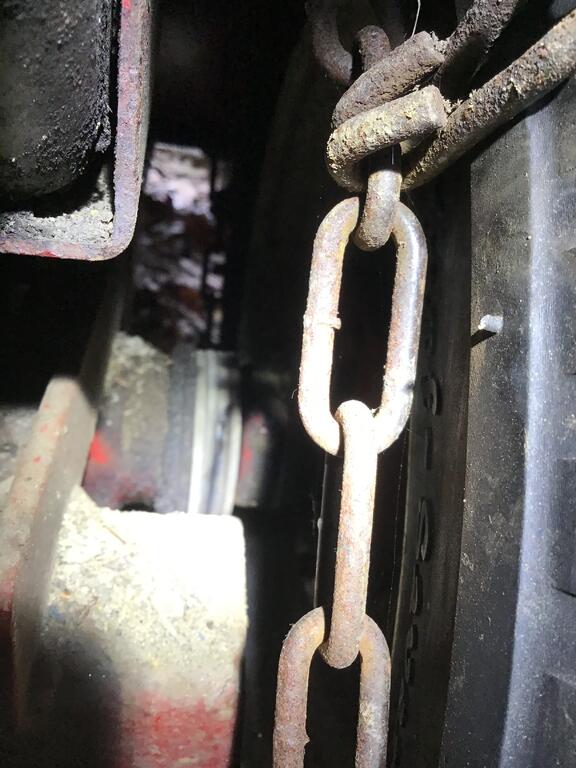

oilwell1415 563 #1 Posted April 27, 2020 I was looking at my tractor today and noticed the axles sticking out of the hubs about 1/4". When I installed them I put the hubs even with the ends of the axles, then tightened the set screws until I was scared plus a little bit, so the hubs have walked in a little bit. Is that something I just have to live with? The hubs were snug on the axles with no slop. I've run the tractor maybe an hour total since I installed them. 1 Share this post Link to post Share on other sites
