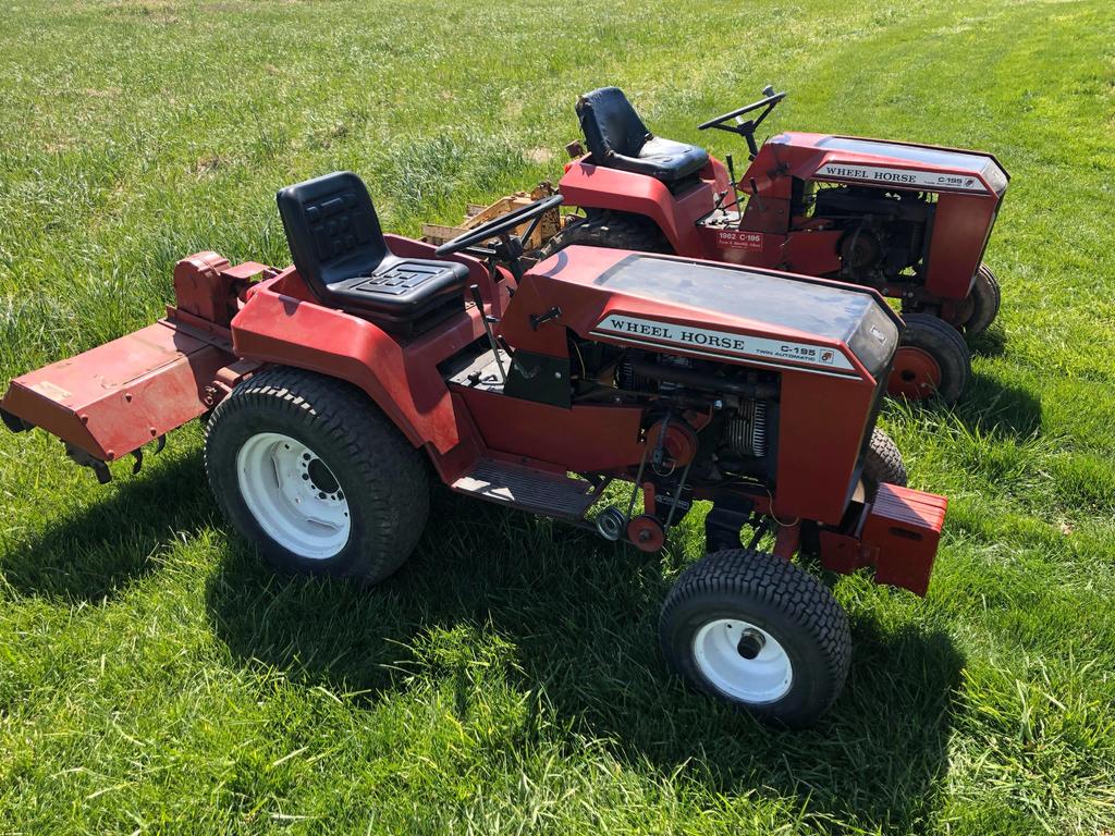

Adams94 1,069 #1 Posted April 27, 2020 Need some advice. I think my pto clutch might be bad, it will slip when running the tiller or 60” finish mower. I tried to adjust it but didn’t seem too help. Also the belt for the rear pto is on the inside groove and if I’m not mistaken it should be on the outside right? 8 2 3 Share this post Link to post Share on other sites

Skipper 1,790 #4 Posted April 27, 2020 (edited) The belt should go on the big front pto pulley, to get the right rpm's on your rear pto. I assume you have the cone clutch? It looks like it from the pics. They slip easily when worn, and can be a hassle to find new linings for. When they are good though, they bite hard. I used to have a lot of trouble with slipping on mine too. Edited April 27, 2020 by Skipper 2 Share this post Link to post Share on other sites
