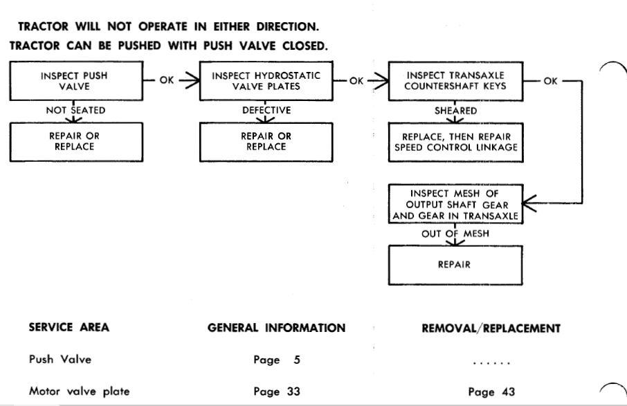

upstate yank 219 #1 Posted April 24, 2020 well guys again i need some thoughts here as the other day i wanted to get the 73 out and run it around the yard as it has been a while ;but anyways all of a sudden the tractor will not go forward or reverse odd really but it happens ;i did check the transmission oil and it is right up there plus the parking brake is released ;i made sure that the valve to have it free wheel was closed as well but still it will not move ;i did notice as well that with the valve being closed the tractor rolls but it shouldn't if the valve is closed so i am wondering what has happened to it ;it has the 16 horse with the auto matic transmission ;any thoughts i sure would appreciate ; Share this post Link to post Share on other sites
pfrederi 18,757 #2 Posted April 24, 2020 Does the lift operate???? Belt slipping?? Check that yu haven't sheared a hub/axle key. 1 Share this post Link to post Share on other sites
upstateyankee50 59 #3 Posted April 24, 2020 3 hours ago, pfrederi said: Does the lift operate???? Belt slipping?? Check that yu haven't sheared a hub/axle key. 3 hours ago, pfrederi said: Does the lift operate???? Belt slipping?? Check that yu haven't sheared a hub/axle key. 3 hours ago, pfrederi said: Does the lift operate???? Belt slipping?? Check that yu haven't sheared a hub/axle key. 3 hours ago, pfrederi said: Does the lift operate???? Belt slipping?? Check that yu haven't sheared a hub/axle key. there is no deck on it and yes i have checked the belt it does not slip ;thanks for the reply and i will have to check the valve as i am not sure if it matters but i did leave that push valve open for a long time it might had got air in ;heck i don;t really know ;in time i will figure it out but just odd it worked fine the last time i used it ; Share this post Link to post Share on other sites
upstateyankee50 59 #4 Posted April 24, 2020 5 hours ago, upstate yank said: well guys again i need some thoughts here as the other day i wanted to get the 73 out and run it around the yard as it has been a while ;but anyways all of a sudden the tractor will not go forward or reverse odd really but it happens ;i did check the transmission oil and it is right up there plus the parking brake is released ;i made sure that the valve to have it free wheel was closed as well but still it will not move ;i did notice as well that with the valve being closed the tractor rolls but it shouldn't if the valve is closed so i am wondering what has happened to it ;it has the 16 horse with the auto matic transmission ;any thoughts i sure would appreciate ; thanks to the guys that replied as i really appreciate it but my thoughts are that the problem is in the motion control unit 'though i could be wrong as the key ways on the hubs are alright plus the belt does not slip ;as i have mentioned i did leave that valve open for a period of time ;not sure if that caused it or not ;i will keep you informed as to what the issue is at least i hope so ;again thanks Share this post Link to post Share on other sites
953 nut 60,625 #5 Posted April 24, 2020 2 hours ago, upstateyankee50 said: my thoughts are that the problem is in the motion control unit Take the cover plate off and watch to see that the plastic cam is moving as it should. Share this post Link to post Share on other sites
upstateyankee50 59 #6 Posted April 25, 2020 4 minutes ago, 953 nut said: Take the cover plate off and watch to see that the plastic cam is moving as it should. thanks and yes i have removed the cover plate and checked the plastic cam ;the thing is on this wheel horse it is so darn hard to find the correct small screw driver to line up with the slot so it could be adjusted but looking at it while trying to turn that cam it looks to me as it is turning as it is busted ;that is even before i turn the small set screw out ;it seems the previous owner who let his small boys mess with it could had done something they shouldn't had ;as i have 3 others that have the automatic and they adjusted very nice but this one not so much ;as before going forward and applying the pedal the shiftier would return to neutral but using the reverse and using the pedal it would not return to neutral as i have to use my hand to stop it ;confusing i know but i am trying to explain the best that i can ;o again i think the cam is the problem ;heck this is all new to me as i have always had standard types but i do like the automatics ;i will figure it out in time i hope ;again thanks so much ; Share this post Link to post Share on other sites
upstate yank 219 #7 Posted April 26, 2020 well guys i was able to figure out why the tractor had issues as it seems i did not close the tow valve all of the way and now with the valve closed it will not roll then i adjusted the forward and revers and it stops on a dime in both directions ;it seems at times we need to walk away and give it time to figure out the issue ;i want to thank every one for there reply back and the help they have gave me ; 3 1 Share this post Link to post Share on other sites
upstate yank 219 #8 Posted April 27, 2020 On 4/26/2020 at 5:20 PM, upstate yank said: well guys i was able to figure out why the tractor had issues as it seems i did not close the tow valve all of the way and now with the valve closed it will not roll then i adjusted the forward and revers and it stops on a dime in both directions ;it seems at times we need to walk away and give it time to figure out the issue ;i want to thank every one for there reply back and the help they have gave me ; yep as we walk away and give it time things come together ;i have to say that this 16 horse is fast ;one day i would like to find the correct mower deck for it ;heck either way i couldn't go wrong for a 100 bucks and had it delivered here by the owner ;again thanks guys for your advise ; Share this post Link to post Share on other sites
