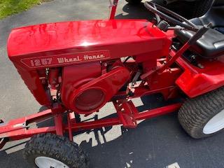

Good Morning everyone.
    Im looking for ideas, or ways to remedy / repair my leaking shutoff on one of the horses. Its threaded in to the bottom of the gas tank, its all metal, and part brass. Its no passing thru the line , but leaking at the screw knob. I would like to keep the shutoff here and not have to add some cheap one inline. its on the 1257.
Much appreciated as always. John
Stay safe and keep it RED.2043781229_1275LSenginearea.jpg.170ee661589cda9781eb75f6b75f99d6.jpg

There will be a screen on that inlet that sticks up into the tank. You can buy new ones from A- Z tractor or online fleabay or whatever.
stevasaurus
That item may have an "o" ring or one of those fiber washers that is bad...much like a faucet.  Take it apart and see if you can take out the shut off knob.

8ntruck
Yup. I agree with Steveasaurus.  Probably a worn out o ring under the gland nut on the shut off valve.
My shutoff valve was leaking last year.  Replacing that o ring solved the problem.

ok so all of you guys were right....I took this darn thing apart, and found that that the inner shaft is separate from the body. I tightened the outer nut that seals the shaft and that's it !!! I cleaned the entire assembly and put it back in....fingers crossed. It was perfect. The knob is tighter, and there is no mere seepage. THANKS EVERYONE !!!!
