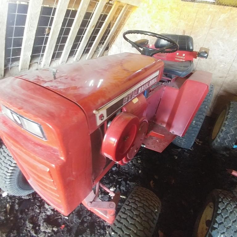

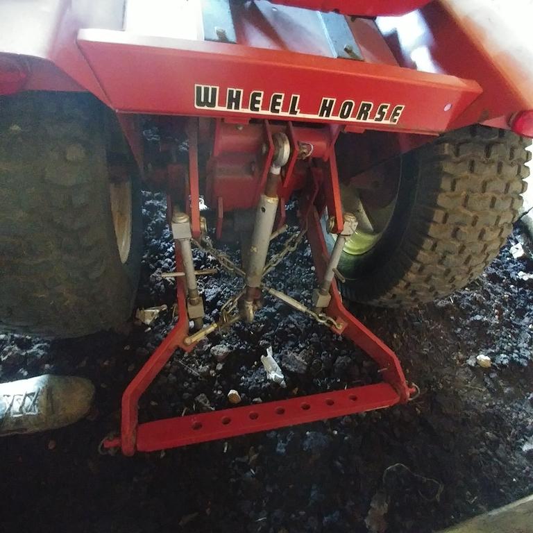

C&W 77 #1 Posted April 26, 2020 Picked this tractor up several years back very clean nice straight gt14 with all the goodies and nice paint go with it and a restored tiller Only one issue that was not addressed when it was being restored main bearings are bad maybe it was overlooked o well gives me project to keep social distanced 1 6 Share this post Link to post Share on other sites

C&W 77 #4 Posted April 26, 2020 Yeah I got to get it dug out hoping to do it in may it sounds bad when shut the motor off thought it was hydro making the wind down sound but it the bearings loose as a goose haha Share this post Link to post Share on other sites

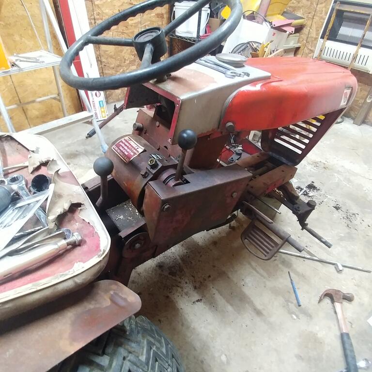

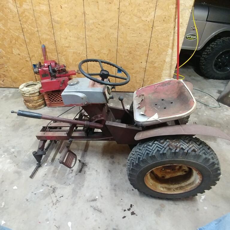

C&W 77 #12 Posted May 4, 2020 Ended up getting side tracked on the gt 14 started working on getting this 702 put together with hy-3 and motor not going to paint it up pretty just get it working and running like a new one One of those pics is what I'm starting out with lol 1 Share this post Link to post Share on other sites
