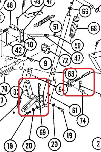

gwest_ca-(File Mod) 11,791 #26 Posted April 26, 2020 From the parts manual Attachment lift and rear lift cable Garry Share this post Link to post Share on other sites

Hoythunter25 46 #29 Posted April 26, 2020 (edited) 1 hour ago, PeacemakerJack said: would love to know what that hitch was built to pull. Looks like a plintel hitch in reverse. It won’t take much to remove all that have what you need to operate ground engaging rear implements. Probably could tell a story or two. I am missing the bars/cables needed to operate the front and rear implements. Edited April 26, 2020 by Hoythunter25 Share this post Link to post Share on other sites

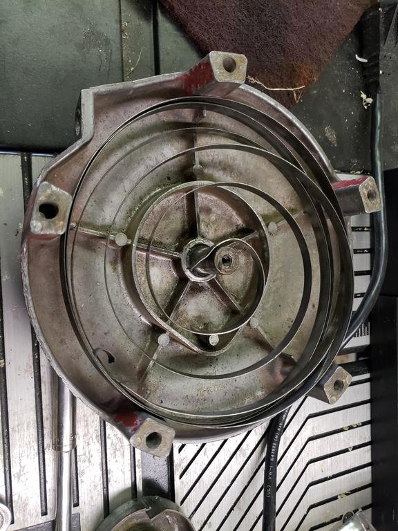

Hoythunter25 46 #35 Posted April 27, 2020 I went and got some essential supplies for trying to get her started. I also started trying to put back together the original starter. Hopefully I can get the jack in the box back together lol 2 Share this post Link to post Share on other sites

tom2p 2,394 #38 Posted April 28, 2020 (edited) 10 hours ago, Hoythunter25 said: I went and got some essential supplies for trying to get her started. I also started trying to put back together the original starter. Hopefully I can get the jack in the box back together lol probably over 20 years since I had one of those pull start assemblies apart the housing was loose on the engine - and pawls on the pull start would barely engage unless pulled quickly so I rarely got a good quality pull - but with the Kohler it barely mattered - barely needed a 1/4 pull and it would start ( and I rarely changed the plug and never touched the points ) when reassembling clean the threads of the small retaining bolt and apply loctite before tightening *** - the pawls should then engage better ( *** I believe 50 - 75 inch pounds ? ) Edited April 28, 2020 by tom2p Share this post Link to post Share on other sites

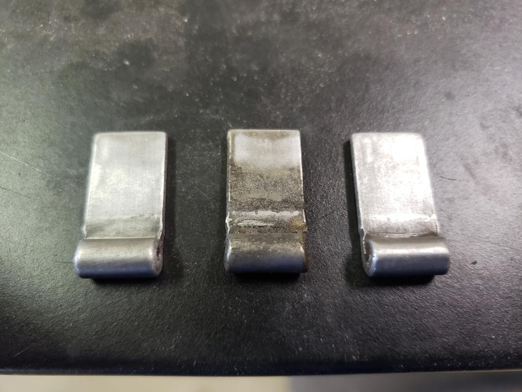

Hoythunter25 46 #42 Posted May 6, 2020 On 5/4/2020 at 4:31 AM, ebinmaine said: What parts do you have already? General maintenance and tune stuff of course. Transmission shifter boot and oil. I have a Kohler carb kit, new spark plug, new fuel line, and new recoil rope. I will hopefully habe everything cleaned up and installed today. Does this engine have points? 1 Share this post Link to post Share on other sites
ebinmaine 75,082 #43 Posted May 6, 2020 41 minutes ago, Hoythunter25 said: I have a Kohler carb kit, new spark plug, new fuel line, and new recoil rope. I will hopefully habe everything cleaned up and installed today. Does this engine have points? Does have points. Yes. Just clean the ones you have. Points file is best. Sandpaper can leave behind residual stuff. You'll be headed the right direction there. Share this post Link to post Share on other sites

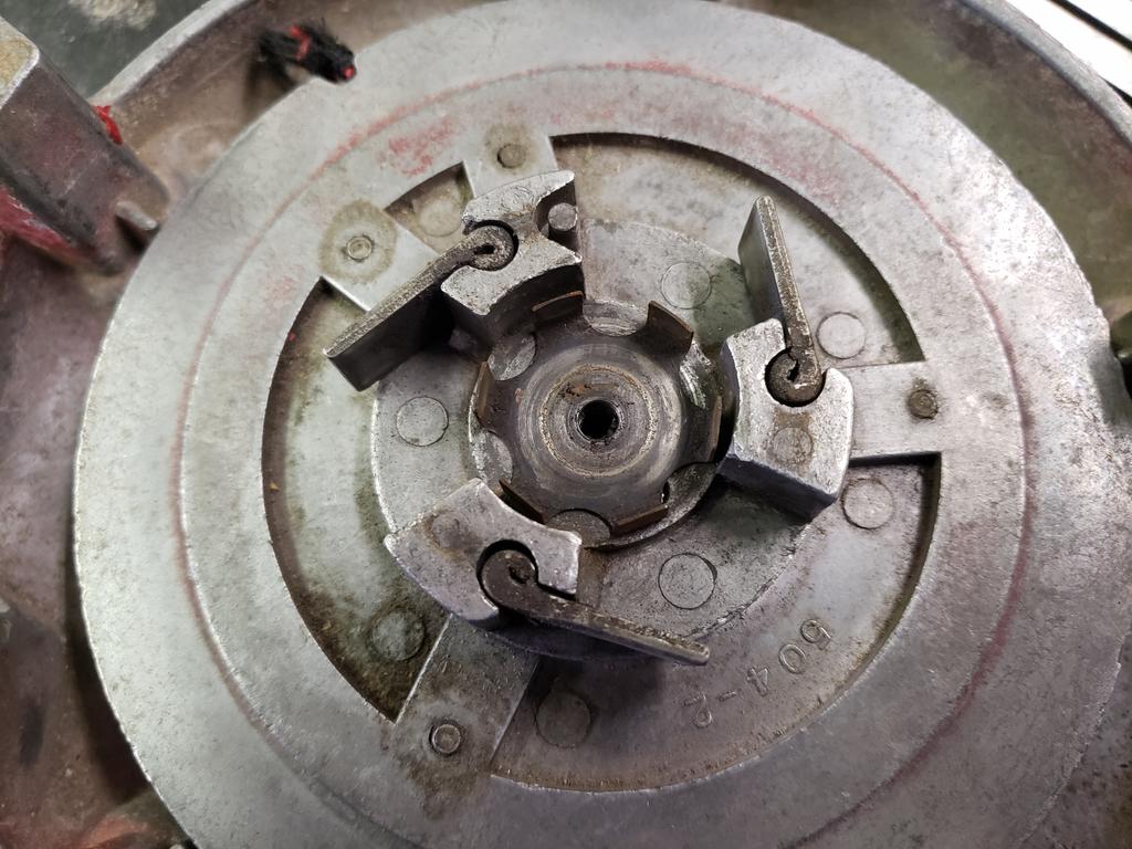

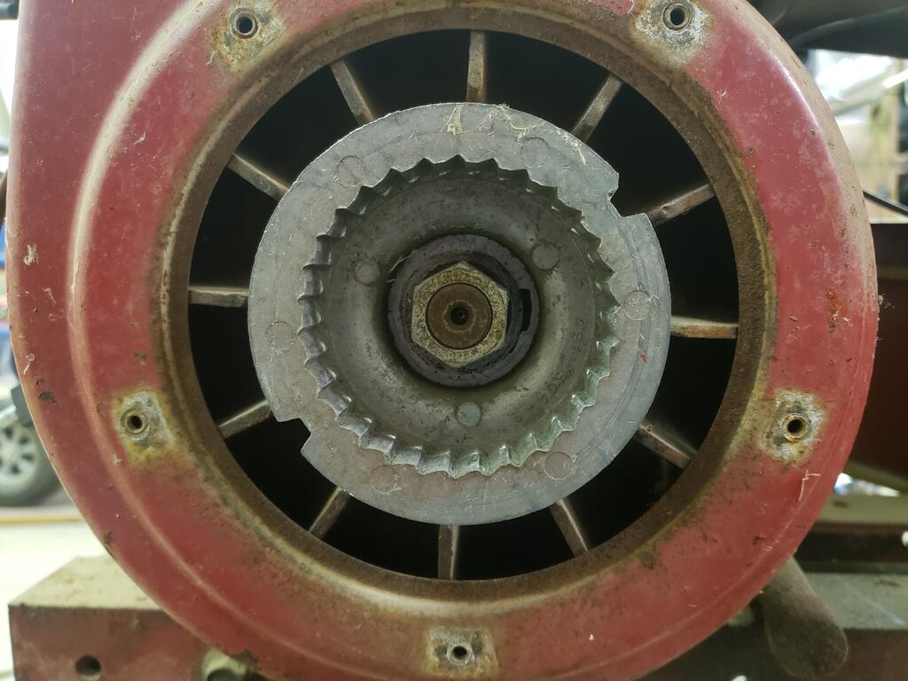

Hoythunter25 46 #44 Posted May 10, 2020 Guys I am having some trouble getting this recoil/starter to work properly. I put it back together last night and pretty sure I have it all correct but it doesn't seem to engage very good at all and when it does it seems like the little dogs are slipping on the inside teeth of the cog on the engine. Any help or thoughts? Share this post Link to post Share on other sites
Hoythunter25 46 #45 Posted May 11, 2020 (edited) Do these go bad often? Edited May 11, 2020 by Hoythunter25 Share this post Link to post Share on other sites

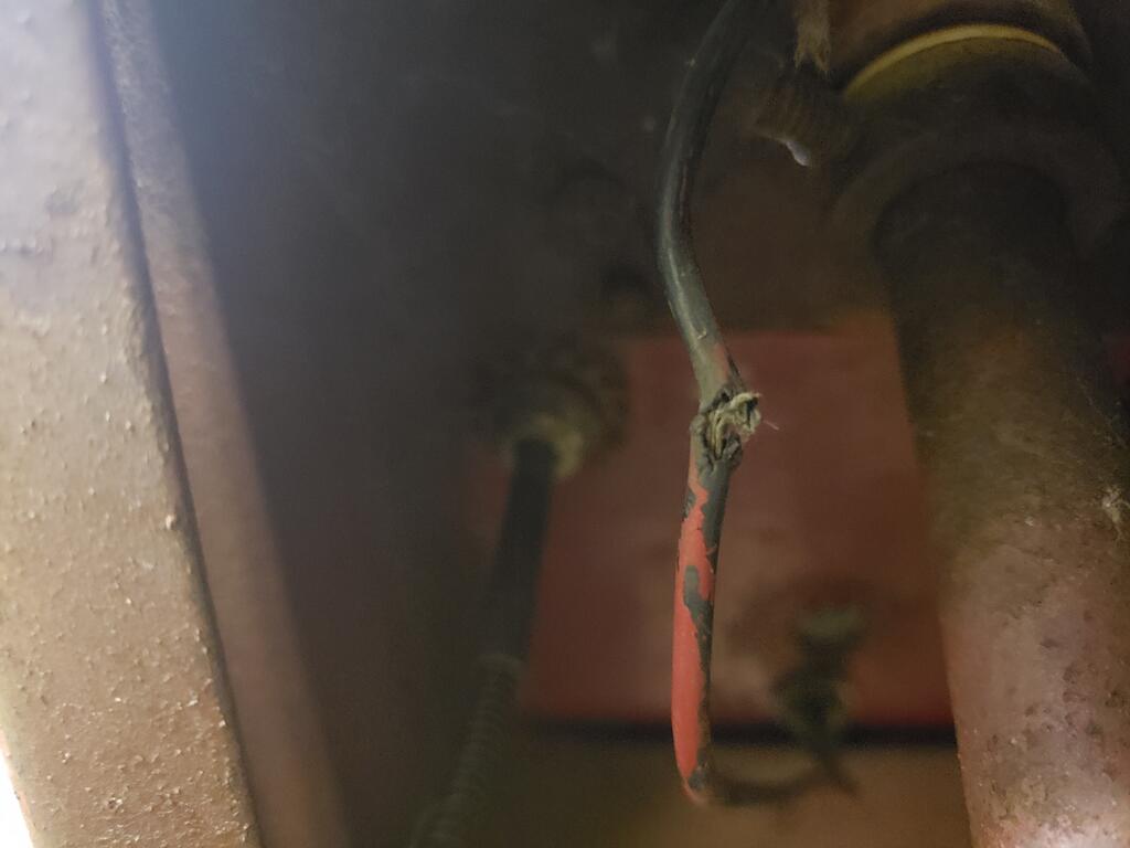

Hoythunter25 46 #46 Posted May 11, 2020 I don't seem to be getting spark....check out this video, do these points seem correct? I also found this bad spot in the wire that goes to the ignition toggle switch. Any thoughts? Share this post Link to post Share on other sites
Sam Pasch 450 #47 Posted May 11, 2020 9 hours ago, Hoythunter25 said: I don't seem to be getting spark....check out this video, do these points seem correct? I also found this bad spot in the wire that goes to the ignition toggle switch. Any thoughts? There is a possibility that the condenser is bad. Also if the ignition switch isn't working it could cause it to not have spark. Share this post Link to post Share on other sites
Pullstart 68,407 #48 Posted May 12, 2020 Do you have a multi meter? Roll it over by hand and have the key on. Check for continuity between the screw on the points wire and ground. wait a minute.. what is rolling the engine over? I thought this was a recoil machine? 1 Share this post Link to post Share on other sites
