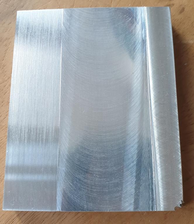

Mickwhitt 5,246 #26 Posted April 27, 2020 Just thought I would try a comparison piece for different machined surface finishes. The piece I used is a chunk of aluminium alloy. On the right hand side is the finish of a 16mm end mill, the centre strip is a fly cut finish and the left hand strip was machined on my Elliott Shaper with a finishing tool. This was a bit of a rushed job but it gives an idea of how different cutters will give finer surface finishes. If I was going for the best possible machined surface it would be surface ground. Then it would be mirror polishing like I do for my knife making. Regards Mick 2 Share this post Link to post Share on other sites
