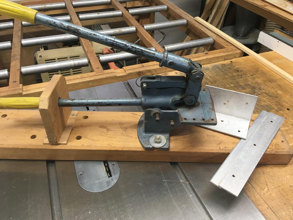

formariz 12,352 #1 Posted April 23, 2020 For aluminum which I use extensively and also bronze and brass instead of drilling I use a Whitney punch. Its quicker safer and the end result a clean hole without any burrs. Have different dies for various sizes and with different hardness for material like bronze. 12 1 Share this post Link to post Share on other sites
