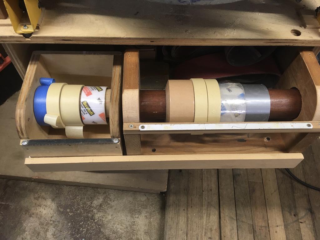

formariz 12,352 #1 Posted April 23, 2020 Since I use a substantial amount of masking tape and others either for protecting work and even as clamping aids, one frustrating part of that was only finding the right roll of tape but having it not peel properly from being crushed while being knocked around . Years back came up with this system. The small one on left can me removed and placed at hand anywhere needed. Just a few pieces of scrap wood and a couple of hacksaw blades makes a big difference. 9 4 1 1 Share this post Link to post Share on other sites
Terry M-(Moderator) 2,271 #2 Posted April 24, 2020 I did something like that on the side of my rolling tool box...never thought of using saw blades like you did....good idea! 1 1 Share this post Link to post Share on other sites
