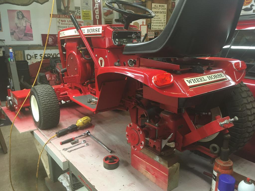

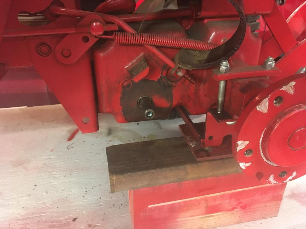

McGrew 461 #2 Posted April 23, 2020 Hi Tim, I just replaced the brake seal on my Raider 10. I am nor sure what transaxle your tractor uses, but the seal on mine was an SKF 7410. It is an easy job, but you need to be careful not to damage the new seal when sliding it over the shaft. Several members recommended using scotch tape to help getting the seal over the two flats on the shaft without damage. I can say it worked great for me! Danny 1 1 Share this post Link to post Share on other sites
