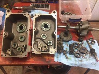

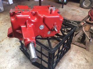

Lagersolut 802 #26 Posted May 8, 2020 On 5/4/2020 at 1:30 PM, stevasaurus said: I just went back over my videos along with looking at your transmission. I don't really see anything that stands out. Were the 2 gears (the reduction gear and the pinion gear) on top of the cluster gear and splined shafts even to the touch??? If yes, I would take an arbor and give the bearing for the splined shaft in the left side case a tap to give it a touch more head space. The bearing for the brake shaft (left side case) should be flush with the outside of the case. Give that one a tap also. Those adjustments should do it for you. Might as well put the dunce cap on me for this ...another where was my head what was I thinking moments - it helps things go together if you don't put the wrong ( 1518 ) bearing where the 1542 is supposed to go Had those new 1518 bearings laying on a shop towel noticed I didn't look close enough the one was shorter ...at that point it hit me ...the base of the 1518 was high enough in the case to bottom out the shaft and bind everything up .. the crack in the spline shaft was the cause of the chatter . All back together with no noise ....took it for a spin back in business . 2 Share this post Link to post Share on other sites
