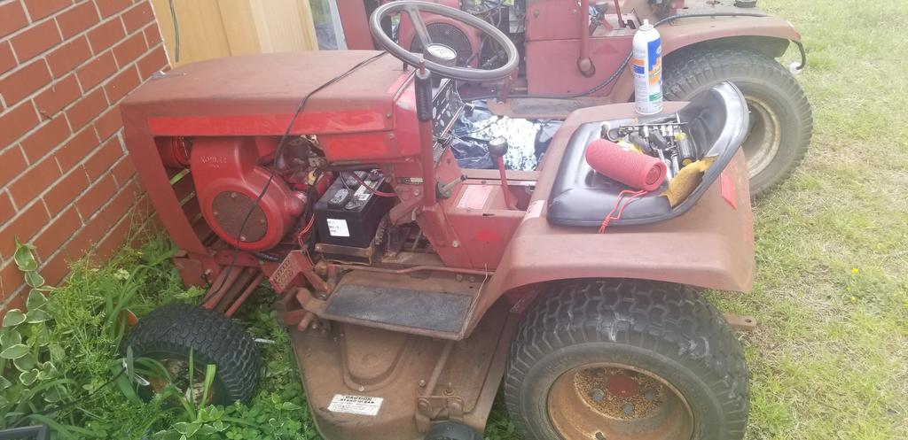

I picked both these up last weekend,
And today They both run,
the 8hp just needed a battery
the C101, needed a fuel pump and the points adjusted. and oil in the gear box looks pretty bad.
Great 400 dollar find.
and my son has laid claim to the 8hp one
The oil in the gearbox looking like coffee with creamer is pretty common.
The shifter boot needs to be replaced. Those are available from one of our vendors. Wheel Horse parts and more.
You should do those on both tractors.
When you go to change the fluid. drain it with the front end as high as you can safely get it. There's a bump in the bottom of the transmission that holds a lot of oil in the front half.
Put about two quarts of diesel or kerosene in the transmission and drive it around in every gear for a bit.
Drain that and add a couple quarts of 80w 90.
