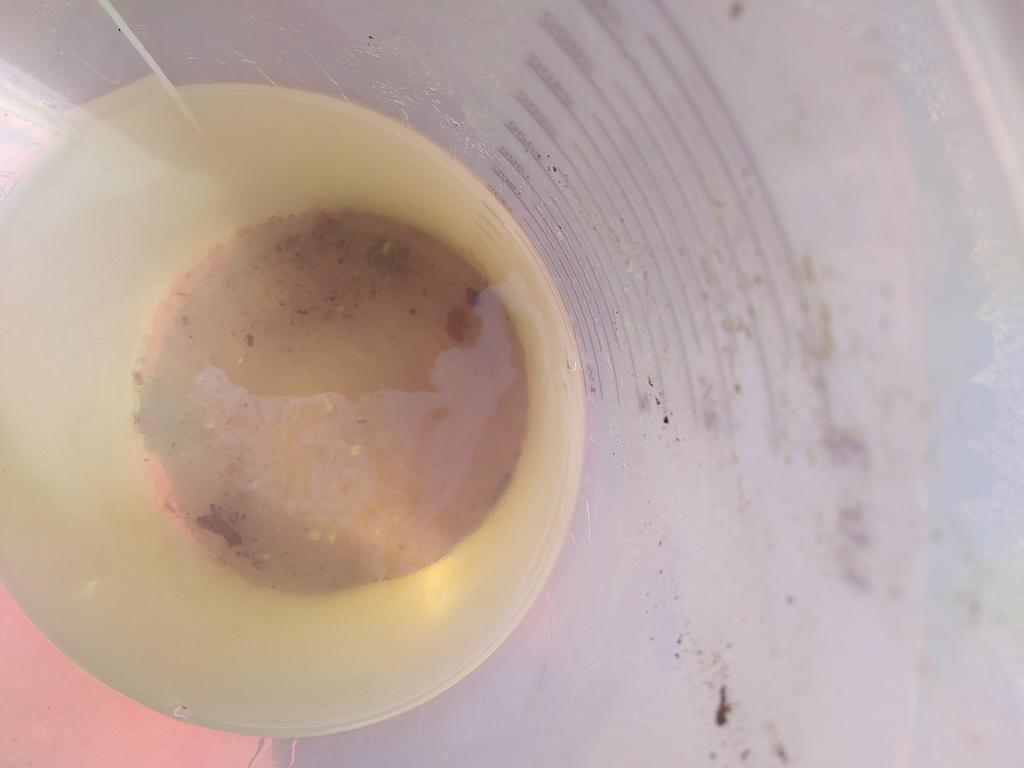

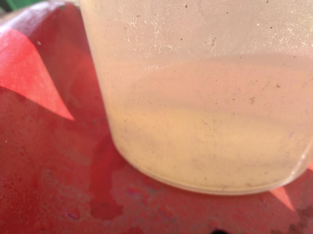

Dan.gerous 2,696 #43 Posted April 22, 2020 Just drained the fuel tank, seems to be a lot of red paint in there! About to give it a wash out. Then I guess it's back to cleaning the carb again 😐 2 Share this post Link to post Share on other sites

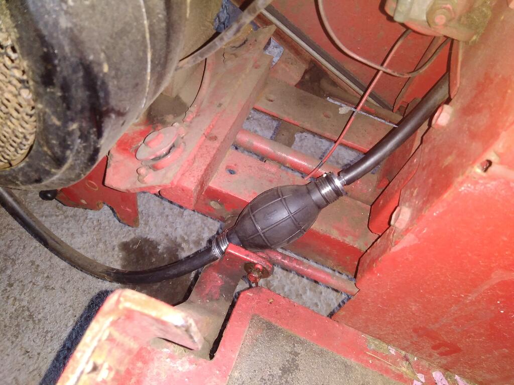

Dan.gerous 2,696 #48 Posted May 6, 2020 Also added this to keep the fuel system primed, no more long cranking in the mornings. 2 Share this post Link to post Share on other sites
Stormin 9,988 #49 Posted May 7, 2020 That's the same primer bulb I have on my C-125 and the Black Horse. Big aid to starting when been idle. I must get one for the C-81 one day. 1 Share this post Link to post Share on other sites
Dan.gerous 2,696 #50 Posted May 8, 2020 7 hours ago, Stormin said: That's the same primer bulb I have on my C-125 and the Black Horse. Big aid to starting when been idle. I must get one for the C-81 one day. Such a simple but effective modification, I need to get another one for the other C125. Share this post Link to post Share on other sites
