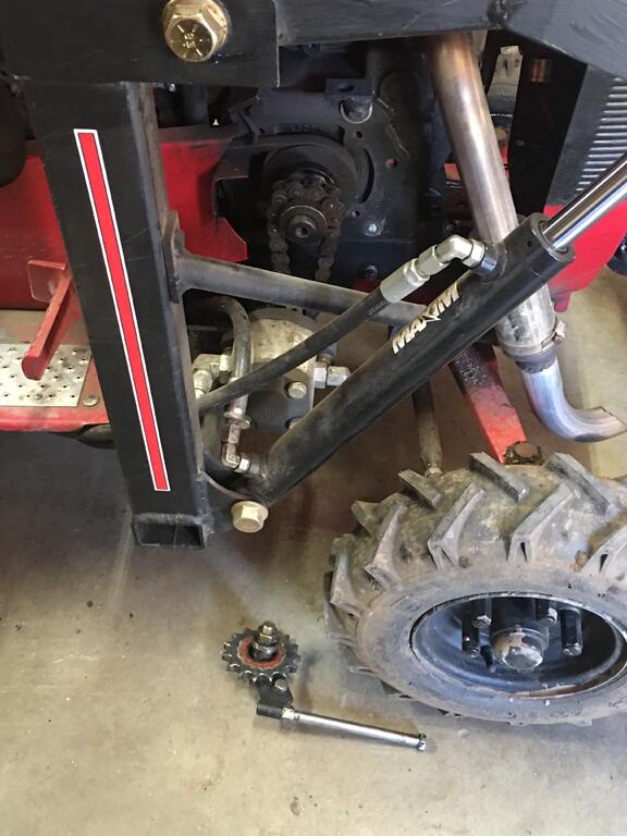

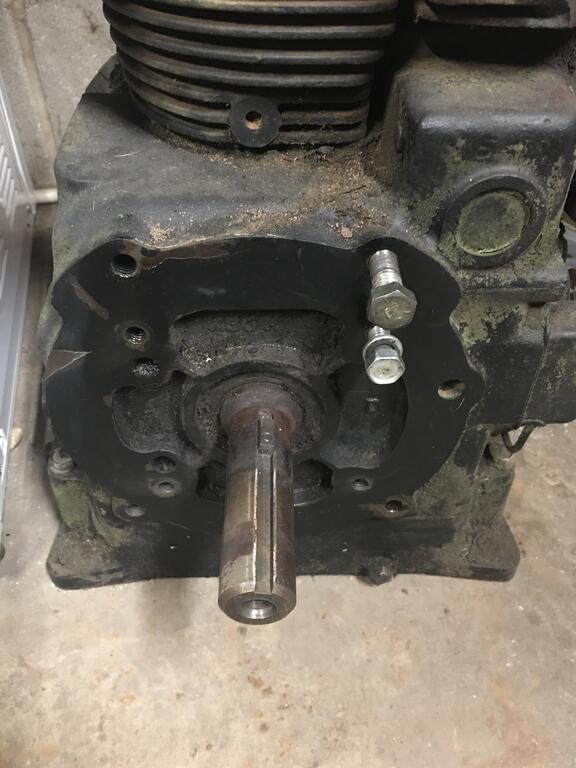

KrazeyOlDave 860 #126 Posted February 4, 2021 Material for a hydraulic pump cage, getting rid of the chain drive, direct hook up to crank. mockup engine for a trial run 😂 1 Share this post Link to post Share on other sites

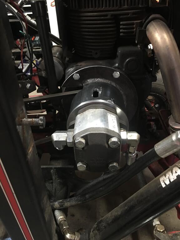

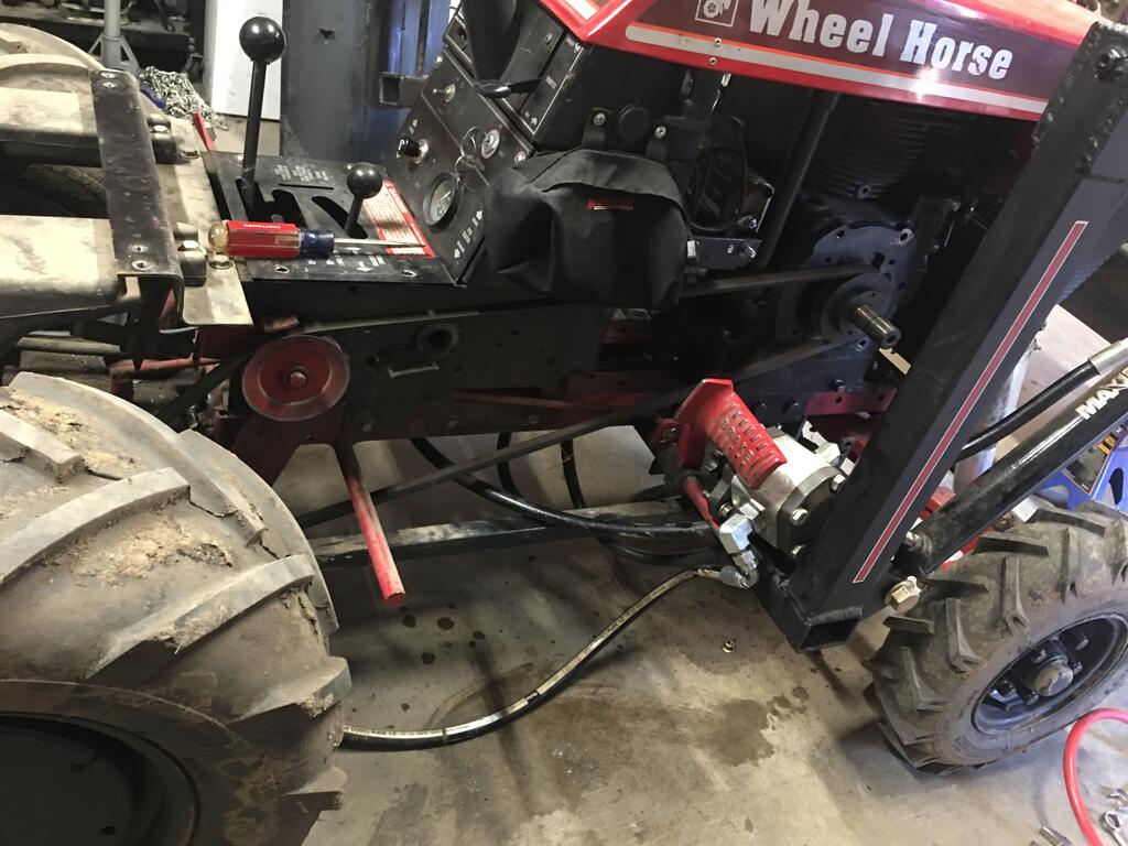

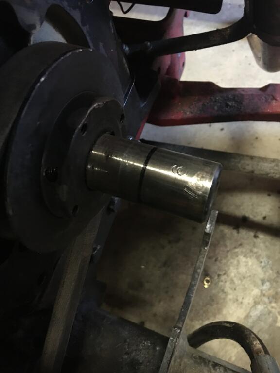

KrazeyOlDave 860 #128 Posted April 5, 2021 Finally getting around to making a hydraulic pump housing. I’m lying, my old setup broke, I was forced to fix it. 😂 IMG_0961.MOV 2 1 Share this post Link to post Share on other sites
Pullstart 71,135 #131 Posted April 6, 2021 Will this be direct drive now, or a coupled drive chain? Is your pump multi-directional? Share this post Link to post Share on other sites
KrazeyOlDave 860 #132 Posted April 6, 2021 10 minutes ago, pullstart said: Will this be direct drive now, or a coupled drive chain? Is your pump multi-directional? Direct with a lovejoy. And I’m not sure to be honest with you, I can turn the pump in both directions freely by hand. Share this post Link to post Share on other sites
Pullstart 71,135 #133 Posted April 6, 2021 Gotcha. Your pump should have either arrows denoting the rotation, or maybe you could look up the model number and it’ll tell you. Spinning the pump, my guess is you can simply swap the hoses for suction and pressure. 2 Share this post Link to post Share on other sites
KrazeyOlDave 860 #134 Posted April 6, 2021 Just now, pullstart said: Gotcha. Your pump should have either arrows denoting the rotation, or maybe you could look up the model number and it’ll tell you. Spinning the pump, my guess is you can simply swap the hoses for suction and pressure. No arrows on it but I’ll send you the info when I’m home. The two ports are different size. 1 Share this post Link to post Share on other sites
Pullstart 71,135 #135 Posted April 6, 2021 2 minutes ago, KrazeyOlDave said: No arrows on it but I’ll send you the info when I’m home. The two ports are different size. That might not end up working so hot. Share this post Link to post Share on other sites
KrazeyOlDave 860 #136 Posted April 6, 2021 Just now, pullstart said: That might not end up working so hot. Oh no, do tell...I’m not a hydraulic guru Share this post Link to post Share on other sites
Pullstart 71,135 #137 Posted April 6, 2021 7 minutes ago, KrazeyOlDave said: Oh no, do tell...I’m not a hydraulic guru There are different types of pumps, like vane or piston style. Some have check balls to only allow fluid one direction. Some do not and are considered bi-directional or multi-directional. I also can’t help but notice the dirt bikes... back on the first page of the build. If you happen to come across a 125 two stroke that I can chase my kid around on her KX65... Could ya let me know? 1 Share this post Link to post Share on other sites
KrazeyOlDave 860 #138 Posted April 6, 2021 Just now, pullstart said: There are different types of pumps, like vane or piston style. Some have check balls to only allow fluid one direction. Some do not and are considered bi-directional or multi-directional. I also can’t help but notice the dirt bikes... back on the first page of the build. If you happen to come across a 125 two stroke that I can chase my kid around on her KX65... Could ya let me know? Ahh ok, I’m familiar with that aspect. It shouldn’t be a problem since I’m still turning it in the same direction as I was? We used to race years ago, we just play around on 4 stroke pitbikes now. The KX65 is one hell of a little beast. 1 Share this post Link to post Share on other sites

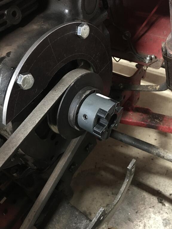

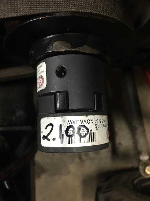

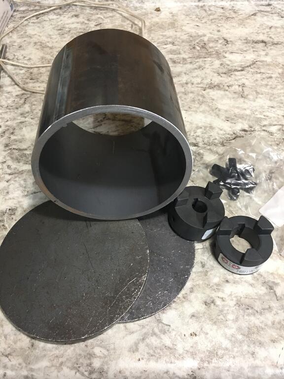

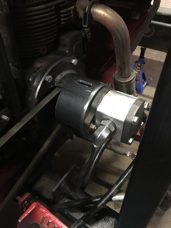

KrazeyOlDave 860 #143 Posted April 7, 2021 Hickerbilly sleeve I made to hold the lovejoys inline, actually worked...not gonna lie, pure luck! IMG_1010.MOV 1 1 Share this post Link to post Share on other sites
KrazeyOlDave 860 #145 Posted April 7, 2021 IMG_1014.MOV 1 Share this post Link to post Share on other sites

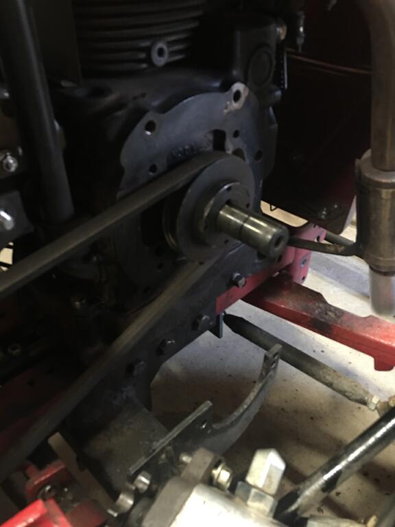

Tractorhead 9,217 #146 Posted April 8, 2021 Nice solution. to work the Clutch you have to support the belt on the underside in lenght i guess. 1 Share this post Link to post Share on other sites
KrazeyOlDave 860 #147 Posted April 8, 2021 3 hours ago, Tractorhead said: Nice solution. to work the Clutch you have to support the belt on the underside in lenght i guess. I’m not following what you are saying about the clutch Share this post Link to post Share on other sites
Tractorhead 9,217 #148 Posted April 8, 2021 When i reworked my 656 beltcover, i see that the main focus shall be on two pieces, firstly the gap between pulley and the belt, second the belt tends if it will be released pulled by force to the Ground. That lower support gives the belt the ability to release without autoengage itself by gravity. 👍 1 Share this post Link to post Share on other sites
KrazeyOlDave 860 #149 Posted April 8, 2021 Much MUCH better, should have done this to begin with! IMG_1024.MOV 1 Share this post Link to post Share on other sites
Tractorhead 9,217 #150 Posted April 9, 2021 Great improve, no beltslip and not much noise from a Chaindrive. 👍 1 Share this post Link to post Share on other sites
