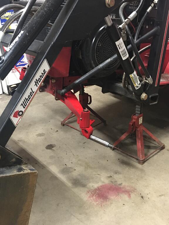

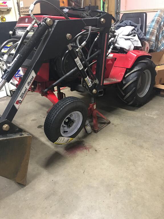

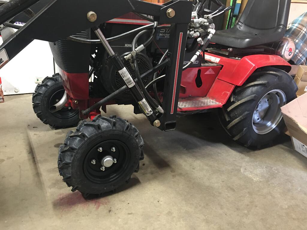

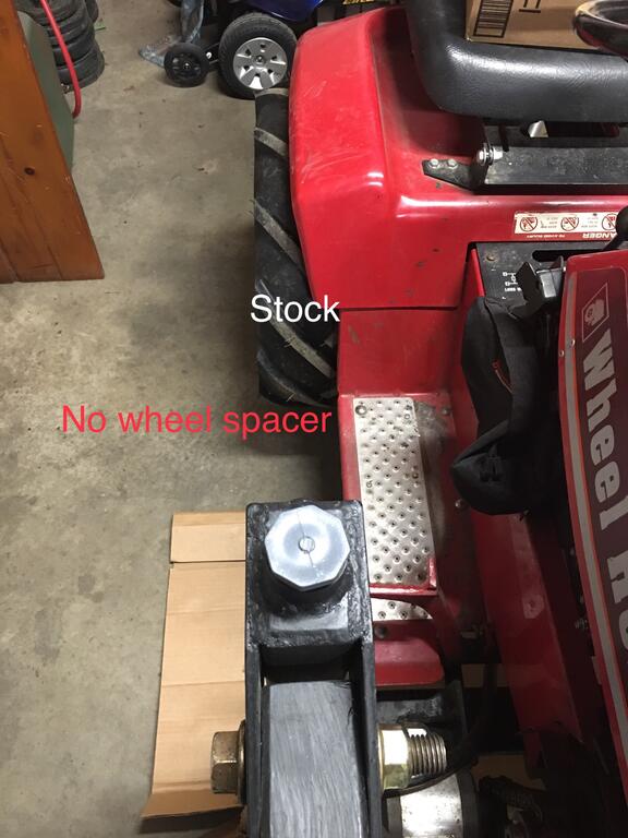

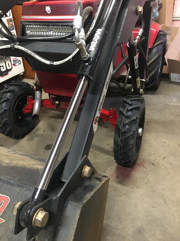

KrazeyOlDave 860 #101 Posted November 7, 2020 3 hours ago, Tractorhead said: The upgrade of the Spindles looks great. I’m using the entire 520 swept front end. That pic was just to show the huge difference, nuts huh? 1 1 Share this post Link to post Share on other sites
Pullstart 71,386 #103 Posted November 9, 2020 So cool Dave! How much wider are you making the bucket now? Share this post Link to post Share on other sites

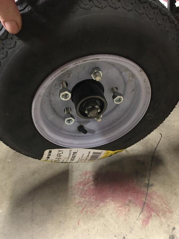

KrazeyOlDave 860 #104 Posted November 9, 2020 1 hour ago, pullstart said: So cool Dave! How much wider are you making the bucket now? Not certain yet till the front is done and wheel spacers are on the back. Probably a simple 2” per side 1 Share this post Link to post Share on other sites

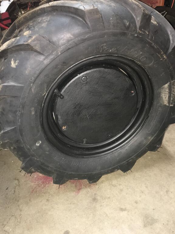

KrazeyOlDave 860 #105 Posted November 10, 2020 I love it, back rims need some ebony 1 3 Share this post Link to post Share on other sites

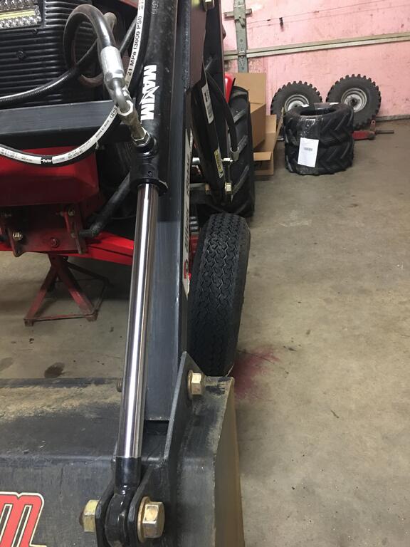

Tractorhead 9,217 #106 Posted November 10, 2020 Looks like a hard Worker. the Front Tyres fit‘s great to the rear Tyres. 1 Share this post Link to post Share on other sites

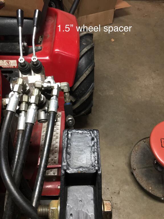

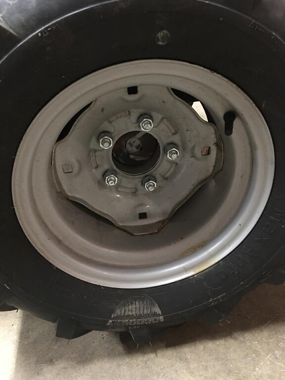

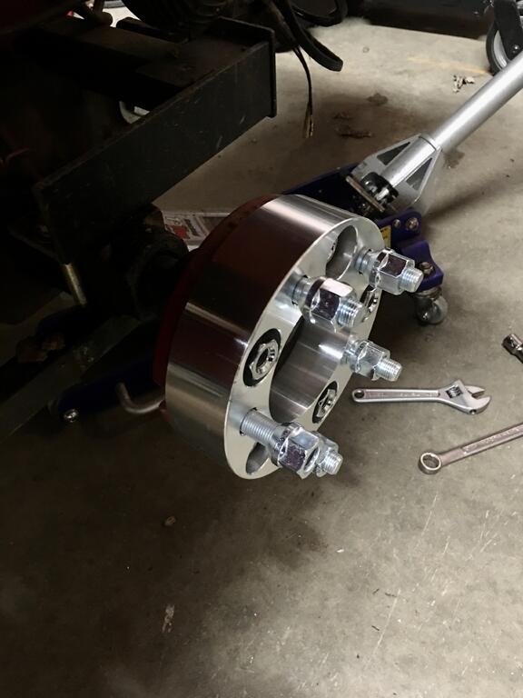

KrazeyOlDave 860 #107 Posted November 10, 2020 (edited) 5 minutes ago, Tractorhead said: Looks like a hard Worker. the Front Tyres fit‘s great to the rear Tyres. Thanks buddy... I’m 1” narrow in the back, 1.5 wheel spacers are going on shortly. Edited November 10, 2020 by KrazeyOlDave 1 Share this post Link to post Share on other sites

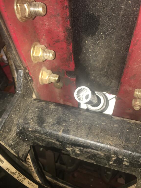

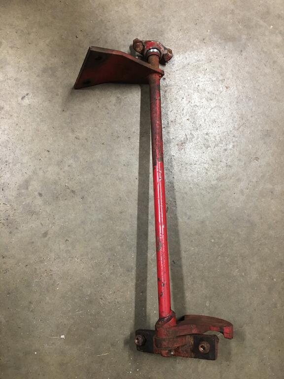

KrazeyOlDave 860 #108 Posted November 13, 2020 Hey fellas, not sure where to ask this... I have the 520 swept steering assembly... will just the main shaft bolt into my 310-8? Share this post Link to post Share on other sites
Pullstart 71,386 #109 Posted November 14, 2020 I’d measure to see the difference, if any. 1 Share this post Link to post Share on other sites
KrazeyOlDave 860 #110 Posted November 14, 2020 23 minutes ago, pullstart said: I’d measure to see the difference, if any. Length is same, I’m gonna try 🤙🏼 Share this post Link to post Share on other sites
Tractorhead 9,217 #112 Posted November 14, 2020 Looks much better and will improve the Stability. 1 Share this post Link to post Share on other sites

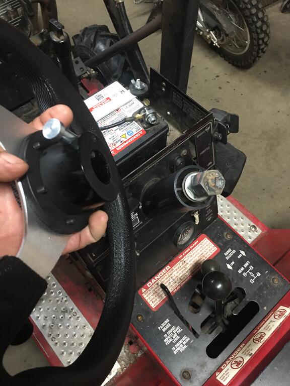

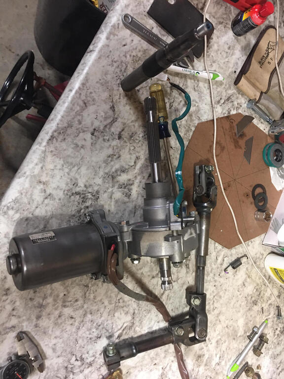

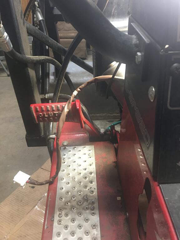

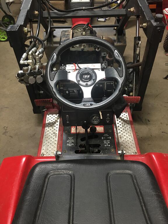

KrazeyOlDave 860 #113 Posted November 28, 2020 Power steering is going in nicely, trying to update as I go (self reference) 😂 3 1 Share this post Link to post Share on other sites

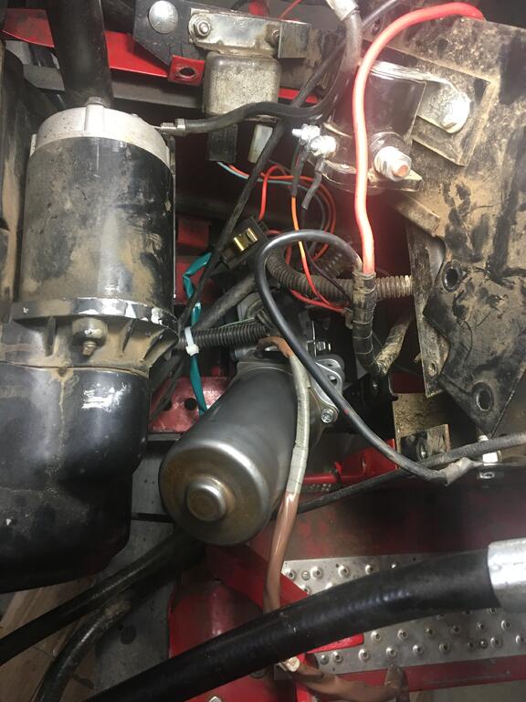

KrazeyOlDave 860 #114 Posted December 3, 2020 Slow going, finding the perfect U joint for up front wasn’t easy. And waiting for upper bearings to show up yet. IMG_8427.MOV 2 Share this post Link to post Share on other sites

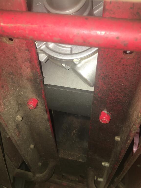

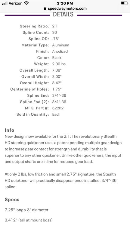

KrazeyOlDave 860 #115 Posted December 7, 2020 Major failure! Plan B.... stock steering with a 2:1 gear reduction. Share this post Link to post Share on other sites
Tractorhead 9,217 #116 Posted December 7, 2020 What was wrong? looked good in first view. Share this post Link to post Share on other sites
KrazeyOlDave 860 #117 Posted December 20, 2020 On 12/7/2020 at 12:07 AM, Tractorhead said: What was wrong? looked good in first view. The electric steering unit is designed to use in conjunction with a vehicle steering box, thus gear reduction is in play. My dumb self didn’t stop to think about that. It just didn’t have the torque for 1:1. 1 Share this post Link to post Share on other sites

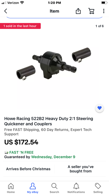

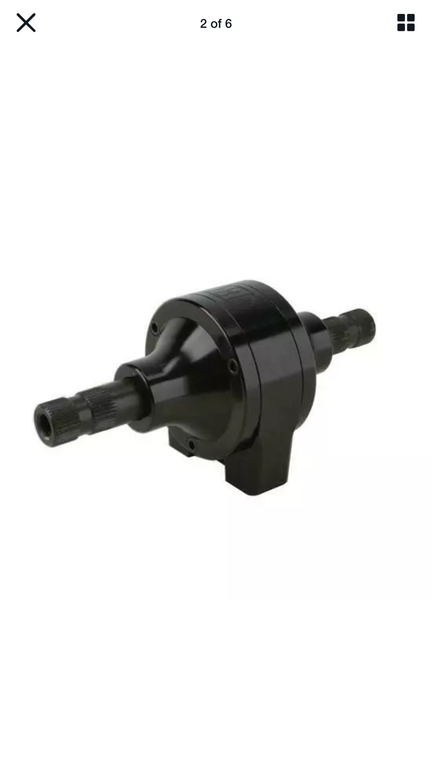

KrazeyOlDave 860 #118 Posted December 20, 2020 (edited) I’m about done with the steering upgrade, although I’m not happy with it at all. The Howe racing quickiner works but it has more loose play in it than I want. Live and learn, pass on the information I guess. If I get sick of it, I’ll strip it and install an Orbital valve and make it all hydraulic. Edited December 20, 2020 by KrazeyOlDave 1 1 Share this post Link to post Share on other sites

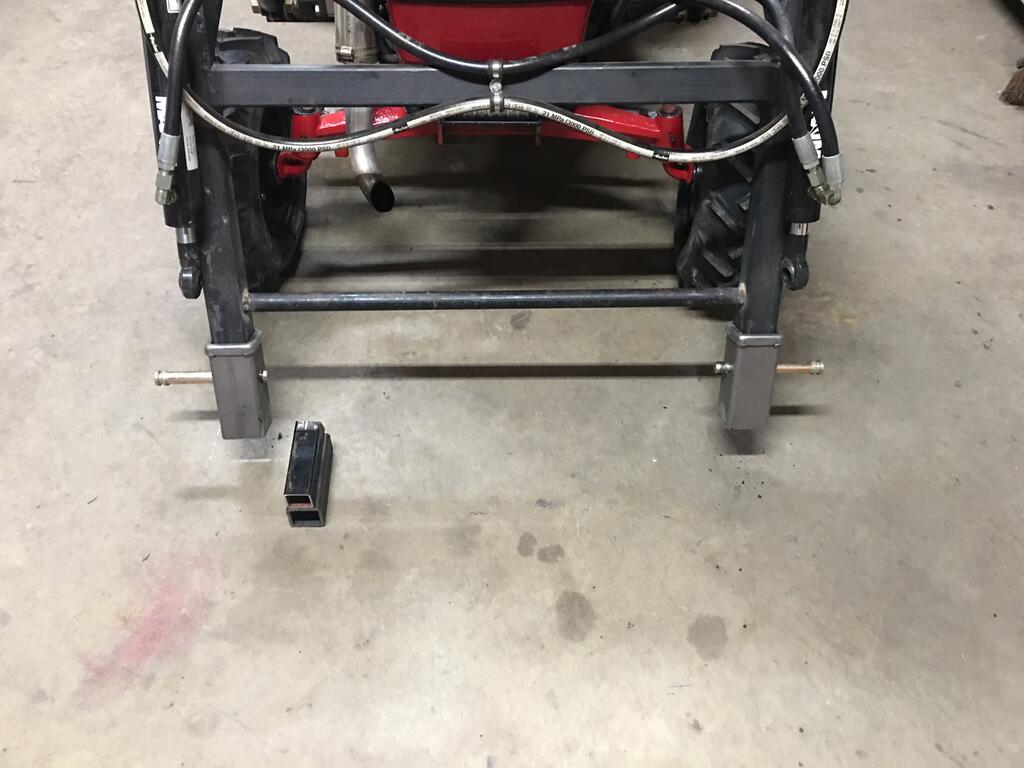

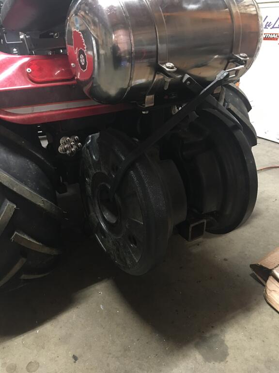

KrazeyOlDave 860 #119 Posted December 20, 2020 66 lbs slug for each wheel, and I couldn’t find the perfect suitcase weights I wanted, so I came up with this rear weight monstrosity. I have end caps coming to hold them from sliding off, using a bungee strap for now. 1 1 Share this post Link to post Share on other sites
Tractorhead 9,217 #120 Posted December 20, 2020 4 minutes ago, KrazeyOlDave said: I’m about done with the steering upgrade, although I’m not happy with it at all. The Howe racing quickiner works but it has more loose play in it than I want. Live and learn, pass on the information I guess. If I get sick of it, I’ll strip it and install an Orbital valve and make it all hydraulic. Just a hydraulic Steering System ain‘t be best idea IMHO in case of a blasted pipe. Without oil absolute no steering is possible on a plain hydraulic system. so even a ride aside in a Safe Area is impossible with drained Oil. I would go more a rework to a golfcart Steering, maybe this is also a Way for you to go. They be available also electro Servo Supported or hydraulic Supported and be so better suited for installation instead of just a hydraulic System And you be able to emergency steer even with completely no Oil in the System. Share this post Link to post Share on other sites
KrazeyOlDave 860 #121 Posted December 20, 2020 1 minute ago, Tractorhead said: Just a hydraulic Steering System ain‘t be best idea IMHO in case of a blasted pipe. Without oil absolute no steering is possible on a plain hydraulic system. so even a ride aside in a Safe Area is impossible with drained Oil. I would go more a rework to a golfcart Steering, maybe this is also a Way for you to go. They be available also electro Servo Supported or hydraulic Supported and be so better suited for installation instead of just a hydraulic System And you be able to emergency steer even with completely no Oil in the System. I guess that’s is something to consider. Those kits are like $500...I’d hate to buy it, install it and it not work,lol 1 1 Share this post Link to post Share on other sites
Tractorhead 9,217 #122 Posted December 20, 2020 Searching also for such a Steering and finally i stuck at Golf Cart Steering for a Project i liked to built, before i bought my 656 Wheelhorse. So i do lot‘s of researching ahead, but with the lack of any Shed or Workshop in that TimelinE, i trashed that Idea. But now that i have my Own Workshop.... 😂 They be offered in the Bay from 90€ Incl. shipping. Powersteering ones are available from 200€ - With electric Support, but that parts you allready have. 1 Share this post Link to post Share on other sites

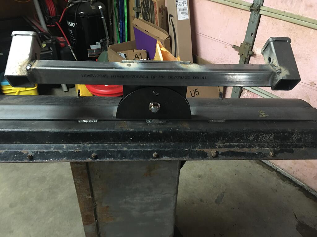

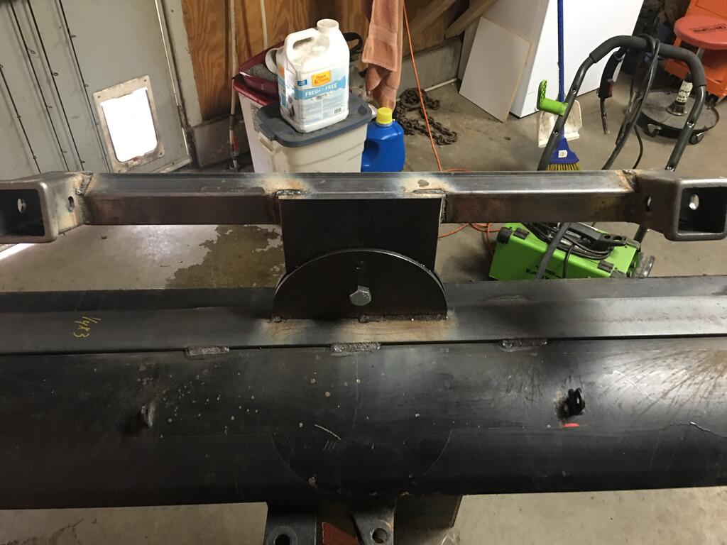

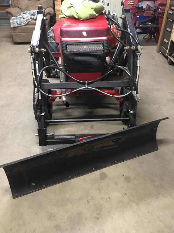

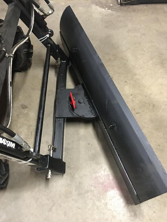

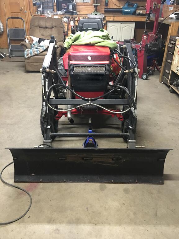

KrazeyOlDave 860 #123 Posted February 4, 2021 Just keeping my build thread updated. 2 Share this post Link to post Share on other sites
elcamino/wheelhorse 9,363 #124 Posted February 4, 2021 That is slick . can you angle the blade left and right ? 1 Share this post Link to post Share on other sites
KrazeyOlDave 860 #125 Posted February 4, 2021 13 minutes ago, elcamino/wheelhorse said: That is slick . can you angle the blade left and right ? Yes sir, left, center and right 3 Share this post Link to post Share on other sites
