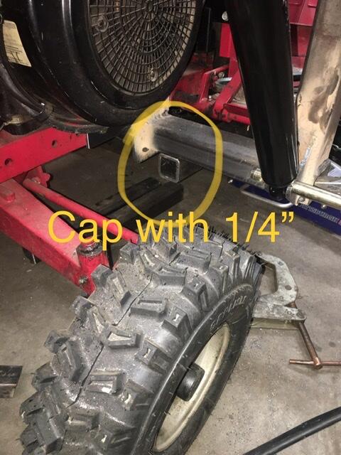

ebinmaine 80,976 #27 Posted April 19, 2020 If the spindles from a B/C would work I've got some I'd sell for a song plus freight. I'm thinking you'd be fine with yours especially if you reinforced them in a similar manner to the pic Paul posted. 2 Share this post Link to post Share on other sites

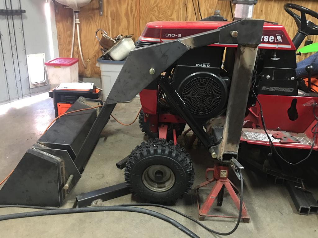

KrazeyOlDave 860 #32 Posted April 21, 2020 You can barely see it but the cylinder is in place. I have the tractor lifted off the ground by 1”, so that I have a small amount of down pressure available. My arm gussets are a bit over kill but I did it so IF ever needed, I can put longer cylinders on it. Probably a waste of time but it’s there. 4 1 Share this post Link to post Share on other sites
Tractorhead 9,217 #33 Posted April 22, 2020 I don‘t think they are overkill, they will last longer as you imagine. Nice design, the only thing you maybe will be missing sometimes is the liftarm lenght. When i built my first FEL, i just want to play with Hydraulics, because i don‘t wanna lift heavyer things myself furthermore. As i get older and as result of my Lifestyle until now, i feel things gettingbharder each year. So actual i use my FEL‘s what they built for, i don‘t lift myself heavier things. At the market when kati purchased planting Soil, they lift it in with a forklift, here i put it out with the FEL. Why carry heavier things with hands, if i had Hydraulic force available? Save your Back! So i learned about my doings, 2 meter’s lift height is a real good Value for universal purposes. 3 1 Share this post Link to post Share on other sites

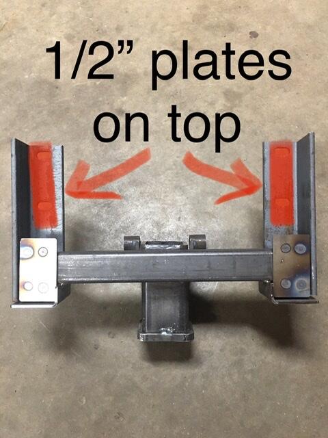

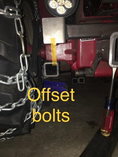

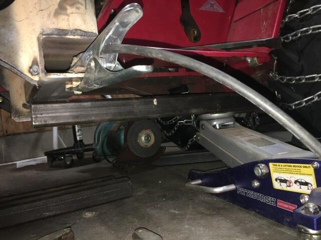

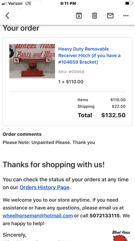

KrazeyOlDave 860 #39 Posted May 1, 2020 Received my hitch today, nice product!!! You guys gave me some great advice thus far so I figured I’d through this up as to how I’m going to tie in my belly arm supports. The forward arms I plan to weld solid, while using grade 5 bolts at the rear end. Pretty straight forward really, thoughts? 2 Share this post Link to post Share on other sites
lynnmor 9,051 #40 Posted May 1, 2020 47 minutes ago, KrazeyOlDave said: Received my hitch today, nice product!!! You guys gave me some great advice thus far so I figured I’d through this up as to how I’m going to tie in my belly arm supports. The forward arms I plan to weld solid, while using grade 5 bolts at the rear end. Pretty straight forward really, thoughts? If you need special bolts, here is a chart. 2 2 Share this post Link to post Share on other sites
KrazeyOlDave 860 #41 Posted May 2, 2020 13 hours ago, lynnmor said: If you need special bolts, here is a chart. Yep, I definitely worded that wrong. Offset bolt holes, loved the chart you posted tho 😂 2 Share this post Link to post Share on other sites
ebinmaine 80,976 #42 Posted May 2, 2020 13 hours ago, lynnmor said: special bolts I've seen that in the past. It's the most fun when a ummm... "Non-mechanical" person doesn't understand that it's funny................... 1 Share this post Link to post Share on other sites
Pullstart 71,386 #43 Posted May 2, 2020 Dave, if you have enough tubing, it would be advisable to run forward past the loader mount and tie it all in with the front attachamatic. It’ll take the shear weight off the center of the tractor and help distribute it to the entire rig. 1 Share this post Link to post Share on other sites
Pullstart 71,386 #44 Posted May 2, 2020 16 hours ago, lynnmor said: If you need special bolts, here is a chart. I’ve never seen that before, but I might have to print it and hang it next to the dril index and tap chart! Those might come in handy! 2 Share this post Link to post Share on other sites
KrazeyOlDave 860 #45 Posted May 2, 2020 1 hour ago, pullstart said: Dave, if you have enough tubing, it would be advisable to run forward past the loader mount and tie it all in with the front attachamatic. It’ll take the shear weight off the center of the tractor and help distribute it to the entire rig. Not a bad idea, honestly, I think I’m reaching the breaking point of this particular tractor. The positive thing is I can retro fit it to a larger model. 1 1 Share this post Link to post Share on other sites
