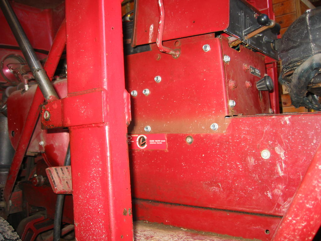

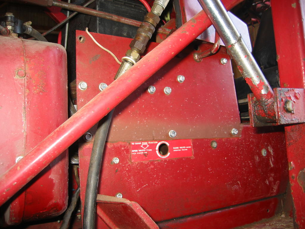

pfrederi 18,452 #3 Posted April 18, 2020 (edited) Tow valve closed??? Left side I have never had to prime the filter on a Sunstrand.... Edited April 18, 2020 by pfrederi Share this post Link to post Share on other sites

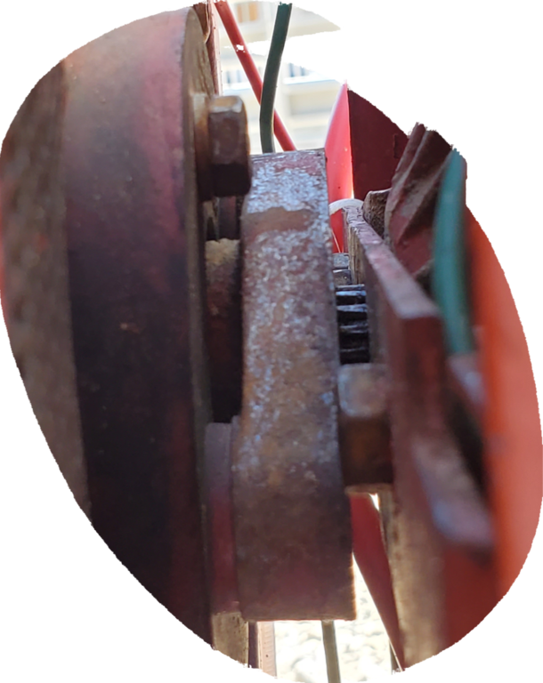

riki1975 3 #6 Posted April 18, 2020 Yes it worked before I changed the fluid. When you say coupler do you mean the area in the attached picture? Share this post Link to post Share on other sites

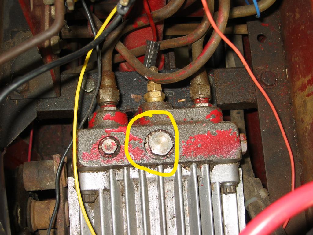

pfrederi 18,452 #7 Posted April 18, 2020 (edited) Yes watch and see if the splines slow down. If it worked well before this is probably not the issue but worth checking. Also put some more ATF in the rear end. even if it is overfull it will settle down when it starts working. The filter on a Sunstrand is on the return to the reservoir so there is no need to prime it. I have never had a problem with my D 200 priming it self but I suppose if your charge pump is a bit weak that may be a problem. D series (of which your Auto 18 is the earliest model) are not always mechanic friendly. To help prime the system remove the battery and you will see the top of the pump. Remove the circled plug and try to pour in ATF Edited April 18, 2020 by pfrederi Share this post Link to post Share on other sites
riki1975 3 #8 Posted April 20, 2020 ok, yesterday I primed the pump but it appeared to be full, I also checked to make sure the hydraulic filter had ATF in it and added additional ATF. I still have the same issues of no lift, forward or reverse. I watched the splines and they did not appear to be slowing down at all. Any other suggestions on what I could try? I appreciate the suggestions. Share this post Link to post Share on other sites
