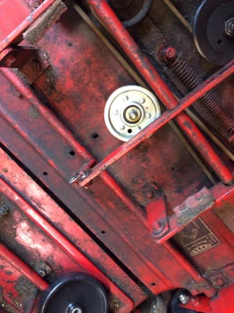

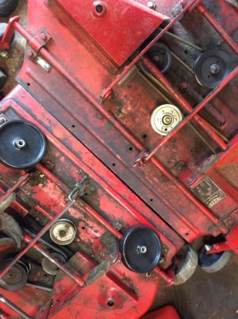

tom2p 2,394 #81 Posted May 9, 2020 (edited) On 5/7/2020 at 12:48 PM, peter lena said: d man , no i don,t have a picture , but on your last picture above , center deck above the tension spring, about 3 " above the single bolt head . i don,t have the belt cover frame , so i drilled just at the flat to down bend discharge chute area. you can easily see the large unsupported belt length , pulley right in the middle of that stretch, lightly pushing toward center of deck. just an experiment that i have on 5 decks , makes the deck quieter too, pete might have pictures of an added idler pulley - see below ( found on this sight - can't recall who posted them ) Edited May 9, 2020 by tom2p 3 Share this post Link to post Share on other sites
"D"- Man 827 #82 Posted May 9, 2020 (edited) On 5/8/2020 at 11:05 PM, tom2p said: might have pictures of an added idler pulley - see below ( found on this sight - can't recall who posted them ) Thanks Tom, that looks to be a 42" deck. I will try to get a picture with my spare idler pulley in the position that I think Pete indicated it should be, when I get a chance. Edited May 10, 2020 by "D"- Man Share this post Link to post Share on other sites
lynnmor 8,740 #83 Posted May 9, 2020 I don't know if that added pulley will cause trouble or not. I have learned while building machinery that you always should have considerable wrap around a pulley to prevent slippage and the resulting friction and wear. 2 Share this post Link to post Share on other sites
peter lena 9,847 #84 Posted May 9, 2020 tom2p, yes those are my pictures of the added idler pulley , and the 6" martin wheels i use on the side corners of the deck , i have this set up on 5 decks ,and it works with no issues. i realise that to others , making a change simply cannot be done. but watching a long unsupported belt flail away , makes no sense to me . thank you for finding the pictures , pete 1 Share this post Link to post Share on other sites
"D"- Man 827 #85 Posted May 9, 2020 Picture the pulley mounted and the belt routed against it, instead of just laying on top of the belt. 1 Share this post Link to post Share on other sites
peter lena 9,847 #86 Posted May 9, 2020 in picture above i do not have that belt guard brace, above the top long stretch of belt looking at rear of deck.as my found pictures show above i drilled hole and mounted pulley at center of long unsupported belt bounce area . no high pressure on belt , but enough to stop bounce. btw the deck looks very well done , pete 1 Share this post Link to post Share on other sites
"D"- Man 827 #87 Posted May 9, 2020 2 hours ago, peter lena said: in picture above i do not have that belt guard brace, above the top long stretch of belt looking at rear of deck.as my found pictures show above i drilled hole and mounted pulley at center of long unsupported belt bounce area . no high pressure on belt , but enough to stop bounce. btw the deck looks very well done , pete Pete, it may be just the difference between the 42" and the 48" decks, the extra support Wheel Horse added to the larger one. 1 Share this post Link to post Share on other sites
