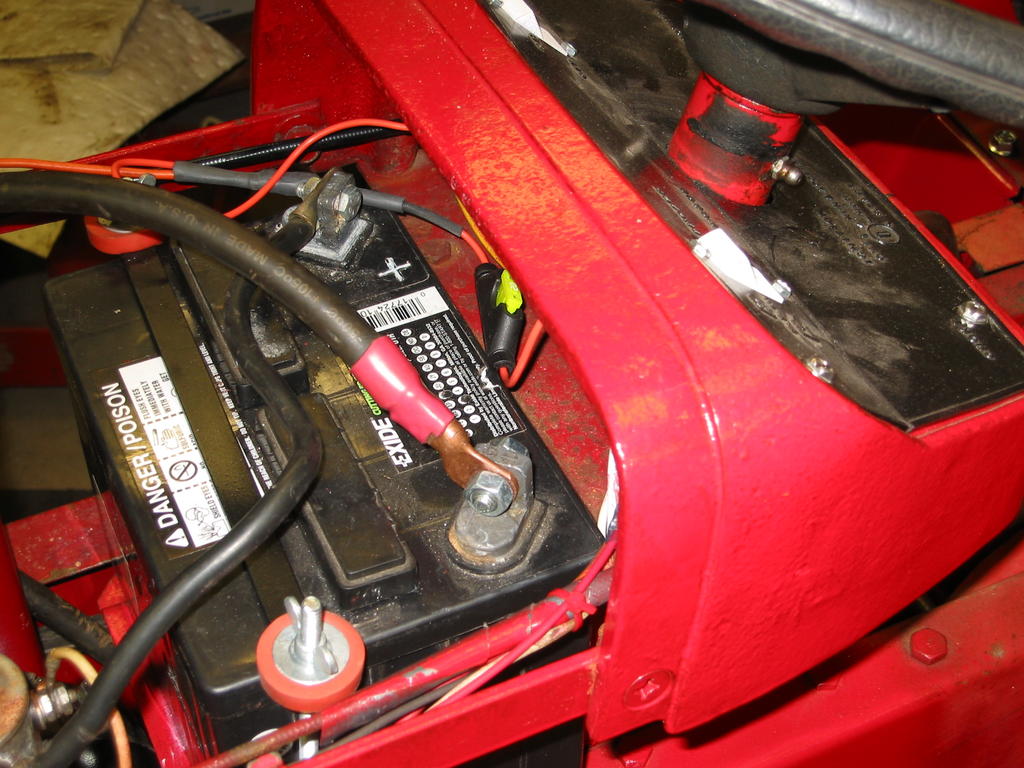

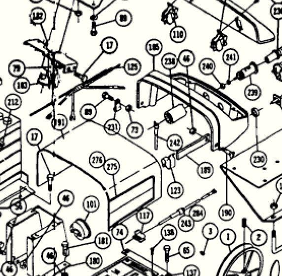

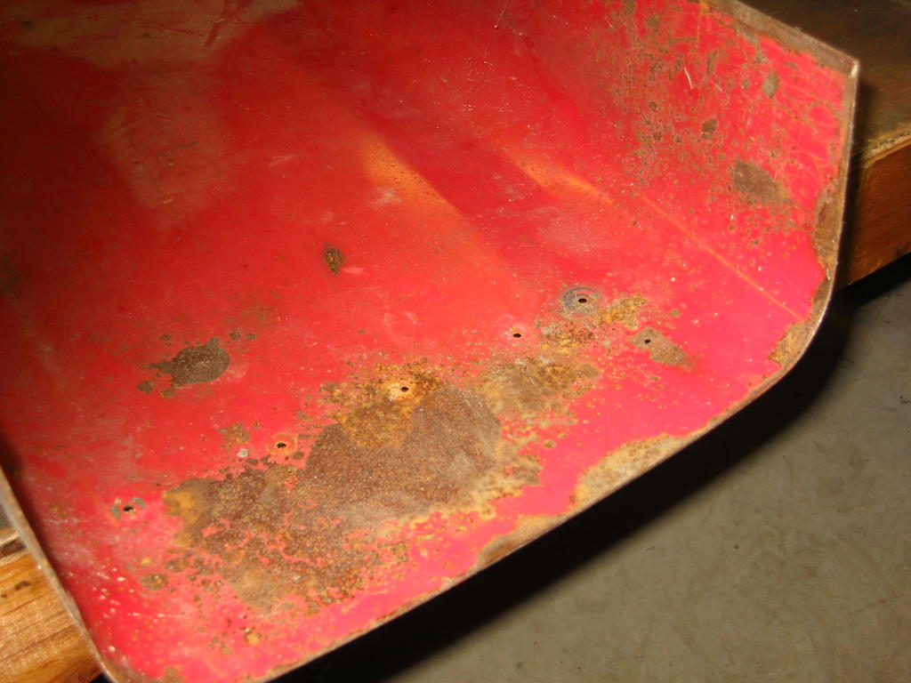

Finally solved all the fuel and ignition issues which had kept the front end off my GT-14.  Ready to put hood on...which wasn't mounted when I bought it. Have the latch for the front but what holds the back on.  Later models had pins on the hood and some slider brackets but not the early model.  The parts diagram is a real eye test but I can see nothing that looks like it holds the hood.  There is a row of holes across the hood but I suspect they are some POs doing.  Do not see anything in the hood stand casting that looks like a pivot point.
Any one have a picture of how this works???

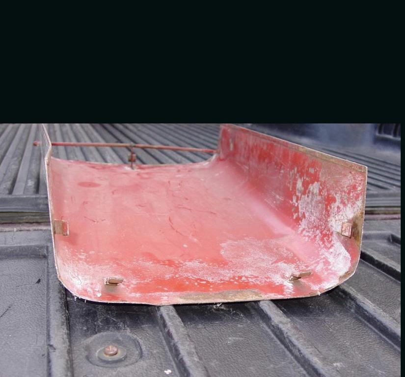

19richie66
They had tabs that slid under the dash from what I have seen. Not sure what all those holes are.

pfrederi
Do you know where the tabs were located on the hood I didn't see any signs of them

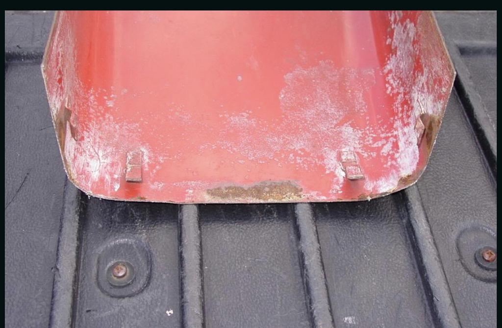

19richie66
Only pics I could find Paul

pfrederi
Thank you .  Don't see spot weld remains on mine but I can make up something .. or just not back up really fast so that it blows off:P

19richie66
I made tabs for mine out of an old pice of wheel horse sheetmetal. Little z bend shaped tabs like in the pictures, drilled two small holes through them and plug welded them to the bottom of the hood
