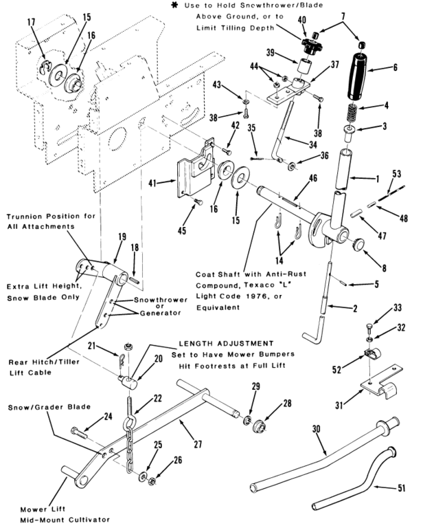

buchshot12000 21 #1 Posted April 17, 2020 Can any assist me with attaching the mower linkage on a 8hp 4spd. specifically were it attaches to the lift lever? Share this post Link to post Share on other sites
peter lena 9,781 #2 Posted April 17, 2020 welcome buchshot ! did a little searching on wheel horse attachment site and , found this , without knowing exactly what you have , the basics are here , let us know your model and any other details , pictures help , pete 1 Share this post Link to post Share on other sites
gwest_ca-(File Mod) 12,015 #3 Posted April 17, 2020 Engine have a horizontal crankshaft? Garry 1 Share this post Link to post Share on other sites
buchshot12000 21 #4 Posted April 17, 2020 well, i guessed right so far. only part left is hooking the lift bar back up to the lever Share this post Link to post Share on other sites
buchshot12000 21 #6 Posted April 17, 2020 7 minutes ago, pfrederi said: Perfect, Share this post Link to post Share on other sites
buchshot12000 21 #7 Posted April 21, 2020 Thanks all, got the mower on and working. Share this post Link to post Share on other sites
