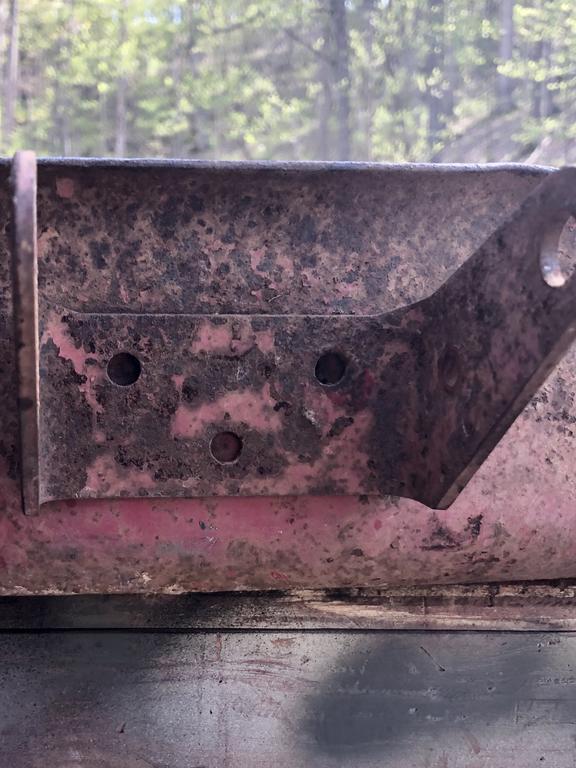

The Tuul Crib 7,340 #1 Posted April 16, 2020 I'm going through this 42 inch deck and stripping it down to clean it up so I can use it. And I'm at these brackets were the rollers go I noticed these three holes. I wanted to take them off to grind out all the rust . The welds would be nothing to cut off. Is there any reason why these cant be bolted back on? Has anyone ever done this Share this post Link to post Share on other sites
SylvanLakeWH 29,320 #2 Posted April 16, 2020 Looks like they just used a same part / bracket for multiple decks. This one waswelded, while others were bolted... Have not done it myself, but see no reason why bolts wouldn't work... 2 1 Share this post Link to post Share on other sites
oldlineman 1,577 #3 Posted April 16, 2020 Might want to use locking nuts though 1 Share this post Link to post Share on other sites
roadapples 6,985 #4 Posted April 16, 2020 Yup, used bolts on mine.... Share this post Link to post Share on other sites
Stormin 9,986 #5 Posted April 16, 2020 Centre one on my 42" deck is now bolted on. Share this post Link to post Share on other sites
