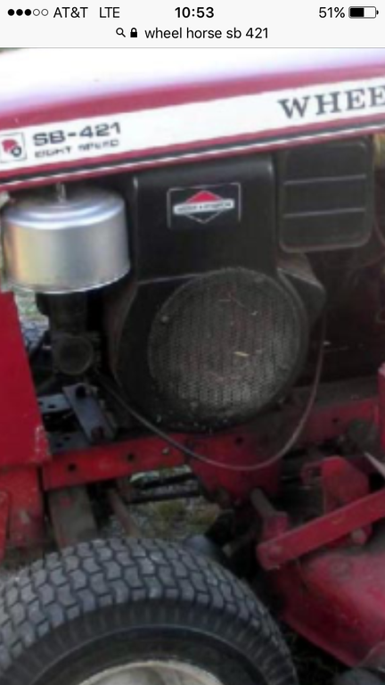

Any kits out there to make a 11 hp Briggs engine pull start? Would like a back up if battery is dead.
I was thinking 3 stand alone posts mounted near the middle that I could wind a rope around and pull. Maybe a different route?

So if I pull the blower cover off I can just mount a pull start?
bds1984
You'd also have to get the matching cup that bolts to the flywheel so the recoil can "catch" and spin your engine over.  But yes, totally possible.

How about a “cup” that bolts to the flywheel like the old rope starters?

Is this available as a bolt on?
