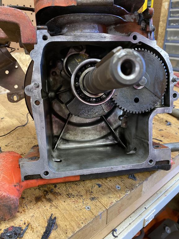

Tripwire 1 #1 Posted April 15, 2020 Need to set the timing on a 8hp Briggs model 190434-0825. Bearing didn’t come along with the case, can I use a gear/ bearing puller to remove this crank bearing to see timing mark on crank gear? Share this post Link to post Share on other sites

lynnmor 8,306 #4 Posted April 15, 2020 You are right to be concerned with using a puller on a ball bearing. If you pull hard on the outer race, all that energy will be transferred thru the balls at their contact point. Check if a new bearing is available before doing possible damage. I would first try squeezing a rag behind the bearing, than hold up the engine by the rag while tapping the crank end with a soft hammer. 1 Share this post Link to post Share on other sites
squonk 44,980 #5 Posted April 15, 2020 You can get a bearing separator from Harbor Freight. Install it behind the bearing so it pulls on the inner race. Use the puller to pull on the separator. Warm up the inner race a bit and it should come right off 2 Share this post Link to post Share on other sites
