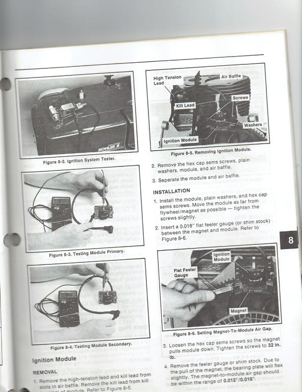

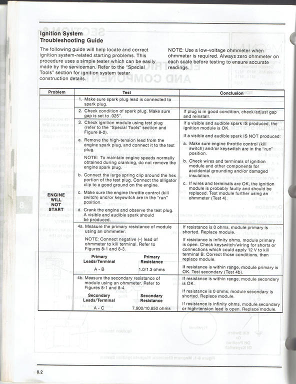

Just to add to the confusion here (Sorry)  You indicated the resistance on the secondary was 14k which is in the range shown in the downloadable manual 7,900 to 20,000.  I have a hard copy manual dated 3/86 (can't see any dates on the electron version). The hard copy acceptable range is 7,900 to 10,850.
yep that looks about right and mine is 14k. Is it possible the coil is bad if its not completely open or closed loop? New good coil is about $70 and I dont have any laying around
