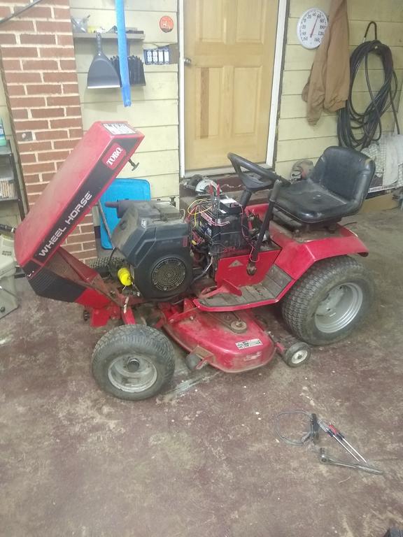

Kfuller2209 9 #1 Posted April 13, 2020 I have tested a couple things and here's what I've found: -When I tested the ignition switch I have power to all the terminals that should have power, and the blue/white wire that runs to the start relay has power when the key is turned to start. -I have no power from the blue wire coming out of the start relay to my solenoid. -The seat safety switch is bypassed(two wires braided together and heat shrink wrap over them), as I said I got this tractor third hand. -I can't figure out how to check the PTO safety switch, when it's engaged the light on my dash doesn't come on when I jumped the two terminals of the PTO switch i got the light to come on. Also when I had the wires to the switch looped together my solenoid made a different clicking sound, still didn't start. -When the tractor is running and I try and put the parking brake on the tractor immediately shuts off as if a safety switch is making it kill the ignition. -I cannot find the clutch safety switch yet. Haven't really dug into the rear end to find it. Thanks again for all the help. Share this post Link to post Share on other sites
Kfuller2209 9 #2 Posted April 13, 2020 I found the switch! Turns out my gear shift has a switch where when in neutral allows the tractor to start. This switch either failed or is out of alignment. I will be fixing this tonight or bypassing till I can get the new switch here. Thanks for all the help and wiring diagrams. It is much appreciated. 1 2 Share this post Link to post Share on other sites
