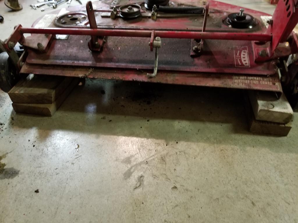

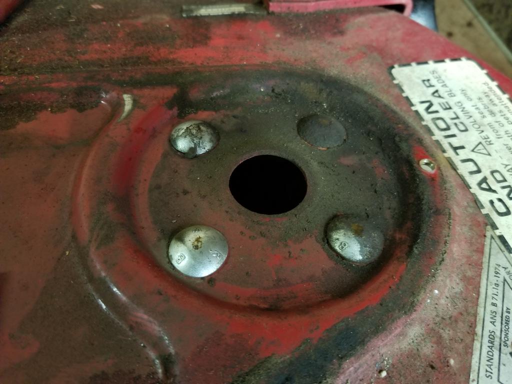

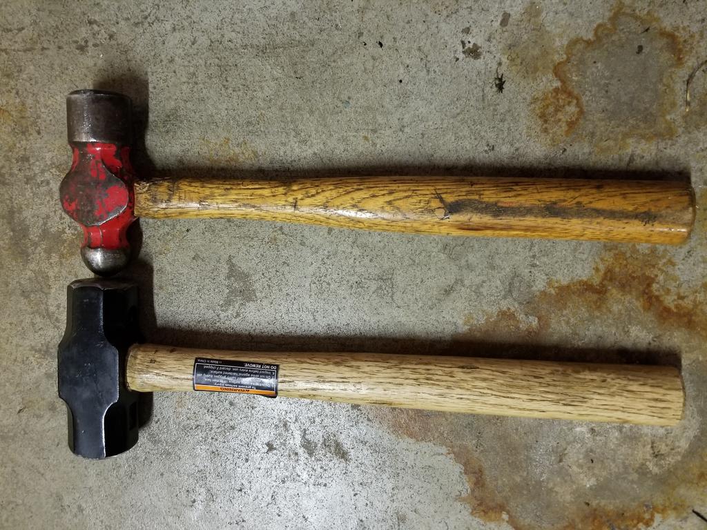

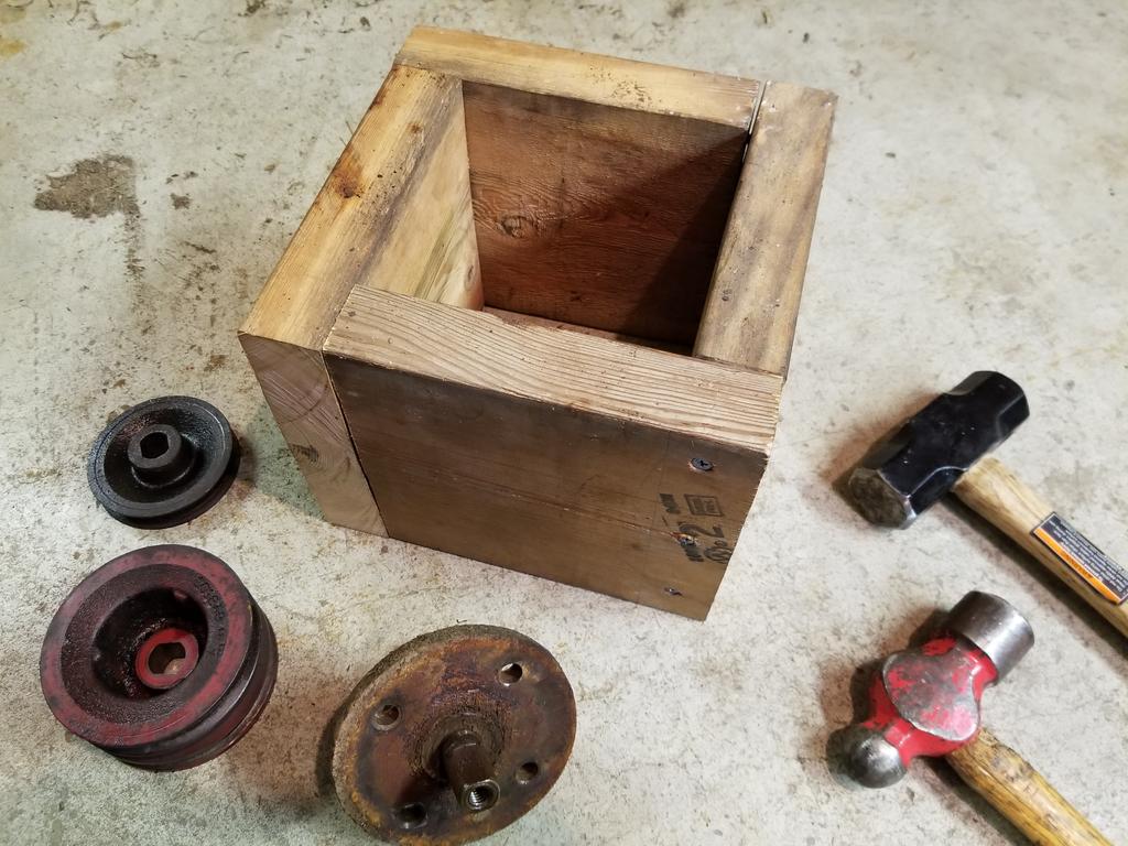

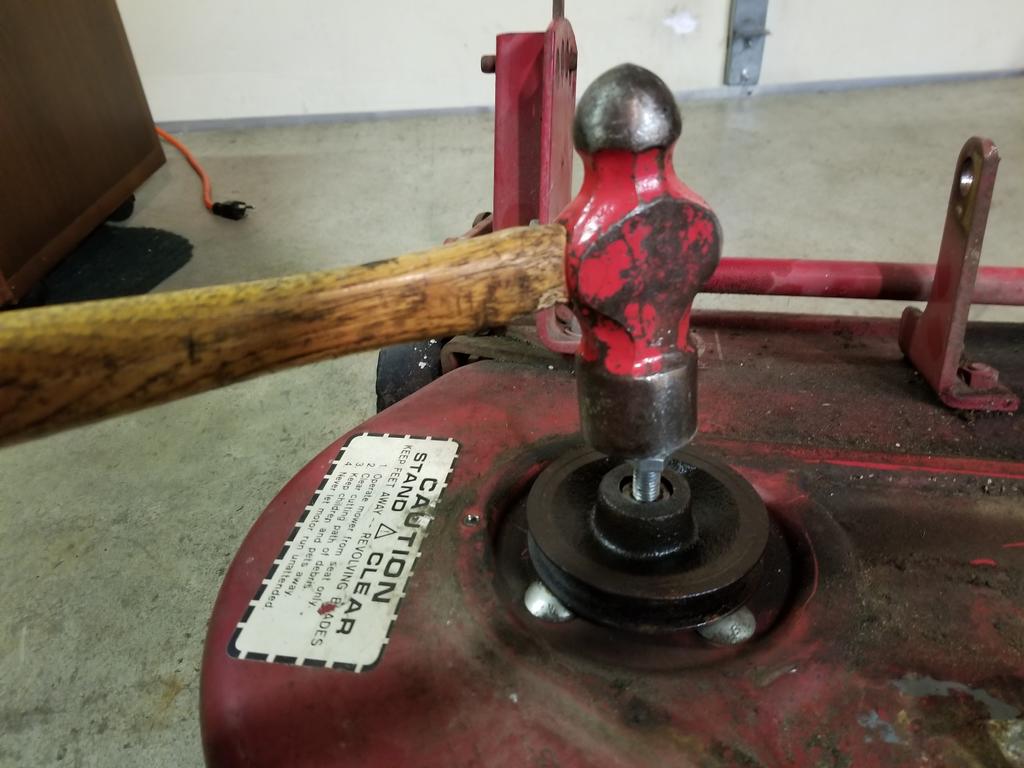

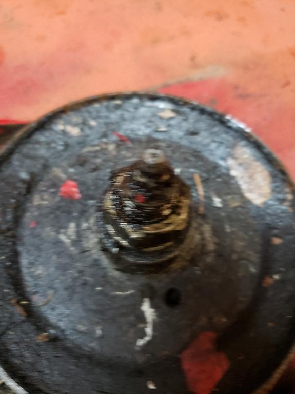

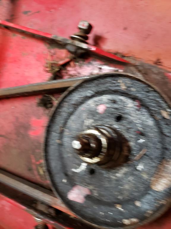

TDF5G 2,073 #1 Posted April 11, 2020 (edited) I rebuilt 2 36" RD decks last weekend that have the old style 103119 bearing. This particular deck in the pics has the cast iron pulleys. I had read several threads about how to remove the pulleys. So I thought I'd try the "whack it through" method. Some posts suggested using a coffee can or concrete block for support under the deck. Here's how I did it: I sprayed each pulley/bearing with PB Blaster for 5 days to soak. Then, I built a box out of some scrap 2"x8" that I had using left over deck screws. I removed the nuts from the carriage bolts that attach the spindle to the deck shell, placed the spindle (one at a time) in the box, (under the deck) and leveled up the deck with some scrap 2" x pieces. I screwed a bolt (not the original pulley bolt that goes back in) into the top of the spindle, held a ball peen hammer on the bolt head and smacked the ball peen with a 3 lb. mini-sledge. Two of the spindles dropped through with one whack. The third dropped with 2 whacks. Easy peasy. No damage to the pulleys or the spindle housings. No worry about damaging the bearings because they get replaced anyhow. I took the spindles to my brother's shop and pressed in the new bearings using his 20 ton press. Done. The deck also got a new idler pulley, belt, and new wheels. Sharpened the blades and she's ready to cut. I had been dreading doing this because I know how hard the pulleys are to remove. Not anymore. I'm ready to rebuild a couple more decks now! Red Square is awesome. It's the best forum on the interweb. I've learned a lot from the great members here. Thanks, Todd. P.S. I found out my 1/4" cordless impact is great for driving deck screws. It was sitting there handy so i used it. Edited April 14, 2020 by TDF5G 5 2 Share this post Link to post Share on other sites

mmmmmdonuts 274 #6 Posted April 12, 2020 (edited) This is brilliant. Sorry if I am high jacking the thread, but I am trying to remove this pulley so I can add a double pulley: It is off of a 1990 48" side discharge deck. I know there are two pulley types and was wondering if this is what yours looked like originally. Basically I am trying to figure out if I can hammer straight through or if I need to do something different. Edited April 12, 2020 by mmmmmdonuts Share this post Link to post Share on other sites
TDF5G 2,073 #7 Posted April 12, 2020 There is a groove in that type of pulley that you can use a power steering pump pulley remover tool. You can find one at most any auto parts store or a place like Harbor Freight or online. 1 Share this post Link to post Share on other sites
mmmmmdonuts 274 #8 Posted April 12, 2020 Alright. Thank you. I wasn't sure exactly what method to use. Thank you very much 1 Share this post Link to post Share on other sites
