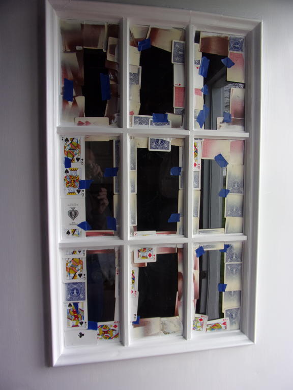

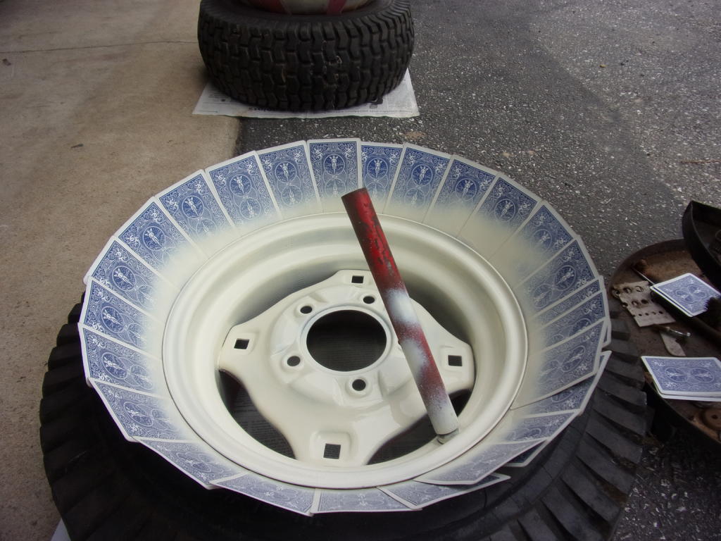

Ed Kennell 47,005 #1 Posted April 8, 2020 We all know old playing cards work well to mask tires. Today I found they also work for masking mullions . 3 6 1 1 Share this post Link to post Share on other sites

formariz 12,381 #5 Posted April 8, 2020 Good idea, masking windows is always drudgery work. It just takes forever. Cards will also probably tuck themselves a little under mullion. Share this post Link to post Share on other sites
953 nut 68,534 #6 Posted April 9, 2020 1 hour ago, Ed Kennell said: masking mullions I have always painted/finished right over the edge and then use a razor scraper to clean the finish off the glass. Gives a clean edge and takes less time. I just refinished our front door and side lights, total of 15 windows, Took less than a half hour to edge scrape all of them. 2 1 Share this post Link to post Share on other sites
