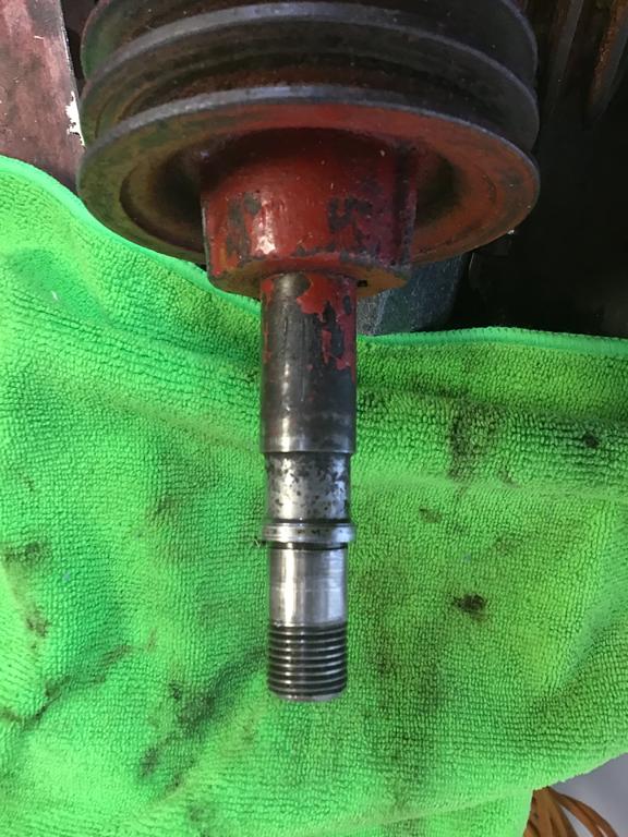

Jshoe1972 1 #1 Posted April 5, 2020 I went to change the two drive belt and ended up tearing the entire deck apart I think I found the bearings that I need to replace. On the attached picture of the shaft that goes between the two blades I remove the nut, gear and bearing. The nut and gear are on the same sized portion of the shaft and then the shaft gets bigger for about 1/8 inch then smaller and then bigger again. The bearing was sitting in the smaller section of the shaft and had been mowing fine. The smaller section of the shaftwhere the bearing was sitting seems perfect like it was machined but I don’t think it was. I have new bearings ordered and I’m not sure what to do. Share this post Link to post Share on other sites
squonk 44,657 #2 Posted April 6, 2020 You need a new shaft, bearing and bearing support. Those bearings seize and lock them selves to that shaft grinding away and then spin in the aluminum support. And you never even hear it do it! 1 Share this post Link to post Share on other sites

Jshoe1972 1 #5 Posted April 6, 2020 Is a new shaft available? I cannot find one. Share this post Link to post Share on other sites

Kelsey 91 #12 Posted July 14, 2020 In the shaft photo: 1) shaft threads 2) smooth bore/ bearing shaft opening 3) cut groove in shaft 4) some sort of hub 5) worn/damaged shaft by old bearing (In the cut groove #3) Is this where a snap ring could be placed to keep the bearing from sliding? Share this post Link to post Share on other sites
